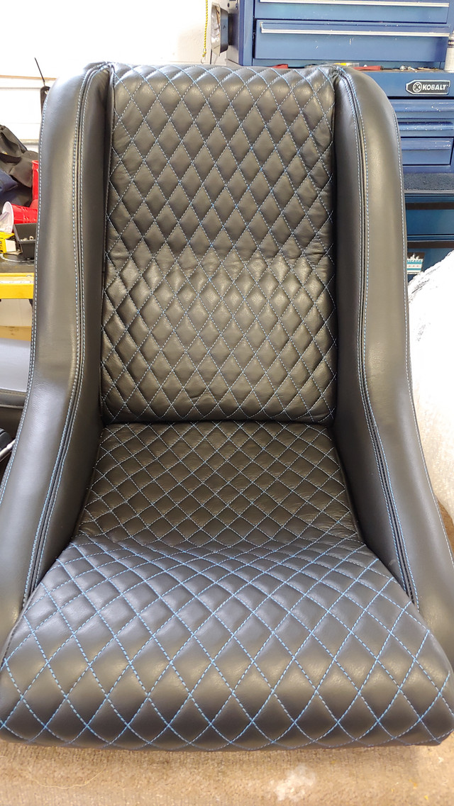

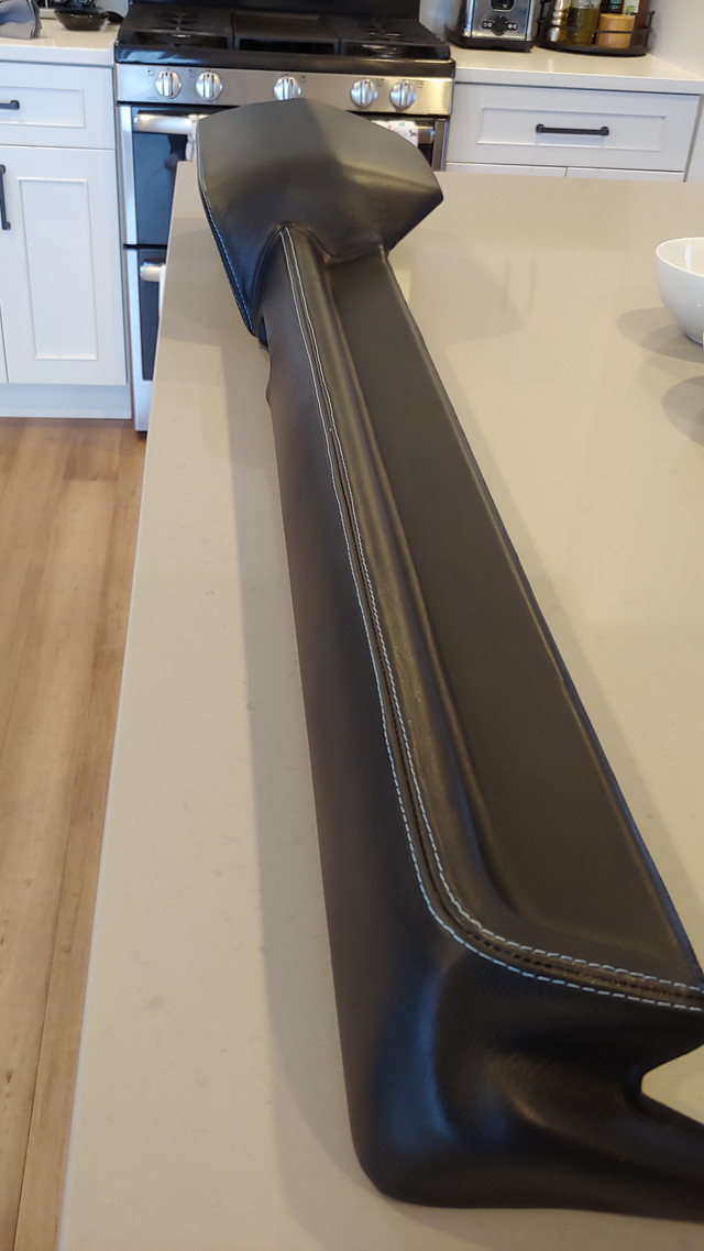

Dash is done. And here a little teaser if the seats. This is going to look amazing

R Dub   Dash is done. And here a little teaser if the seat...   Feb 1 2020, 11:41 AM
R Dub   Seats are done. What a difference. Start to put th...   Feb 28 2020, 09:43 PM
