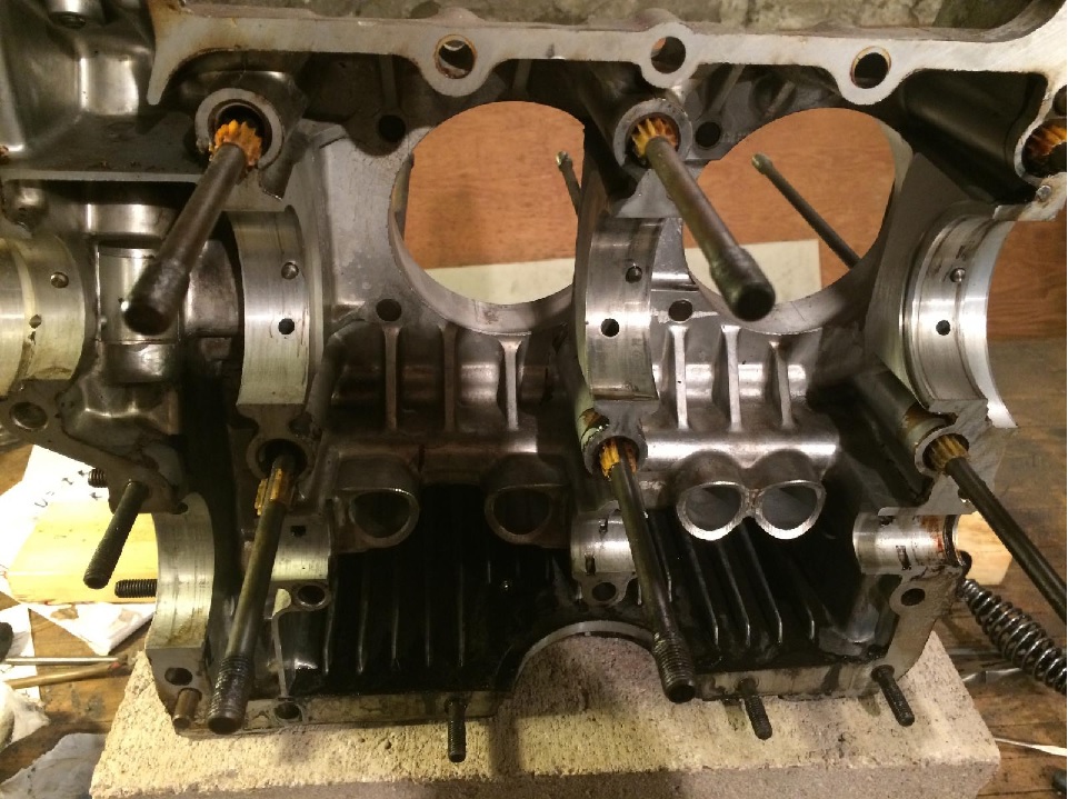

Are there eight in the kit or six? They go on the long through case bolts, not the head studs:

BeatNavy   Are there eight in the kit or six? They go on the...   Feb 4 2020, 06:51 PM
TheCabinetmaker   6 vibration dampers on case thru bolts. Have never...   Feb 6 2020, 06:55 AM
