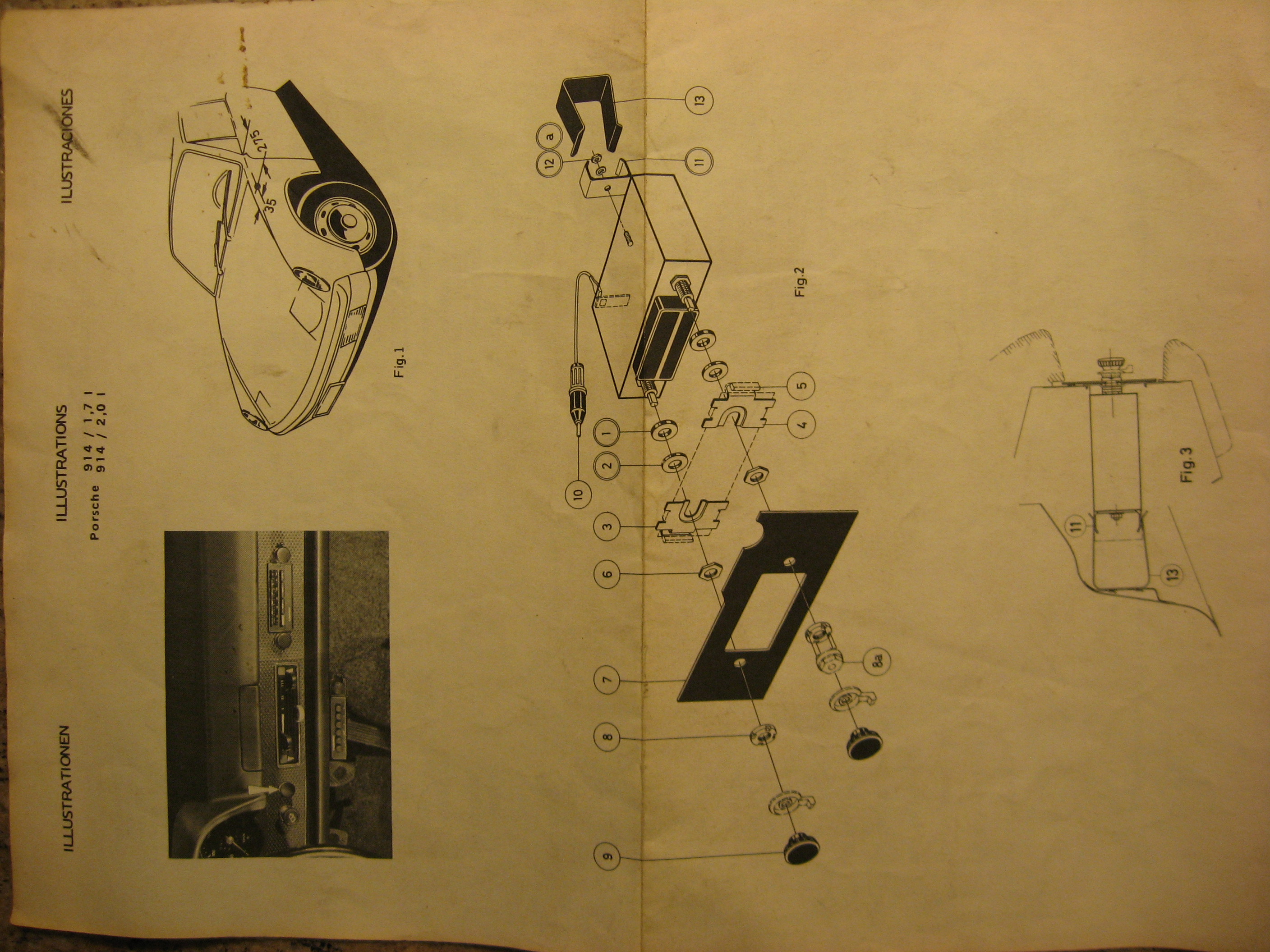

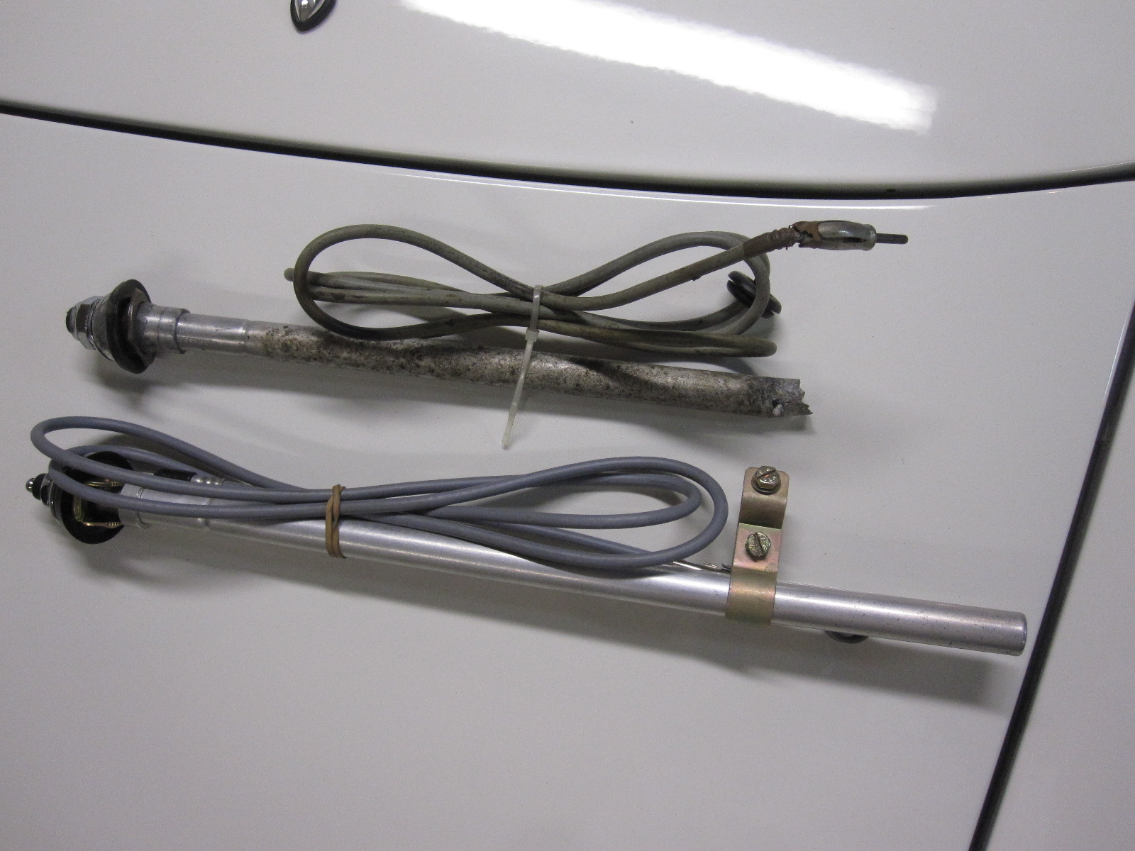

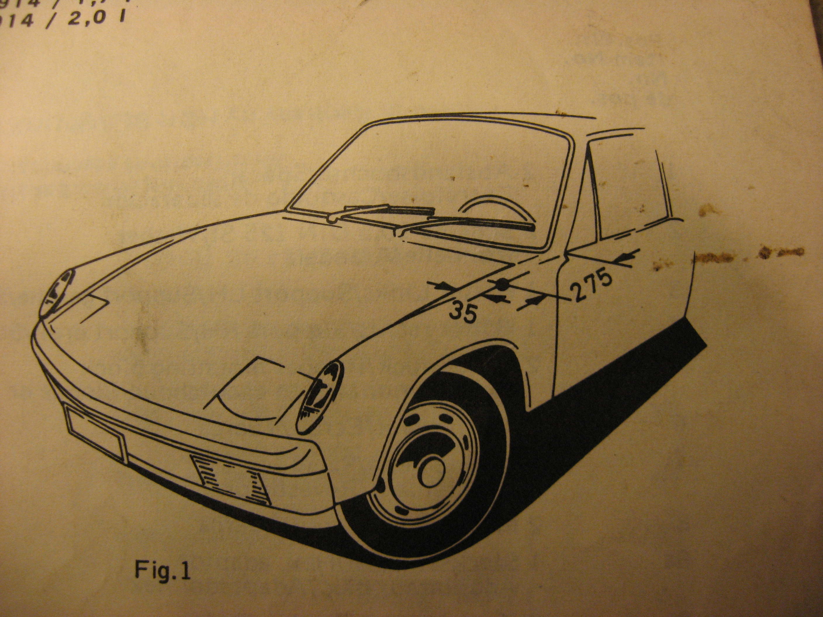

All 914's have two factory holes on the drivers side that are there for only one reason. Antenna installation.
One is on the drivers inner fender, it always has a rubber plug from the factory.
It's for the wire to extend into the wheelwell.
The other hole is in the vertical pinchweld behind the tire. It's for a bracket that supports the antenna. See pic.
There is also a factory diagram showing proper location of hole in drivers fender.
I'm looking for that photo.
Neither of my cars have a radio.
