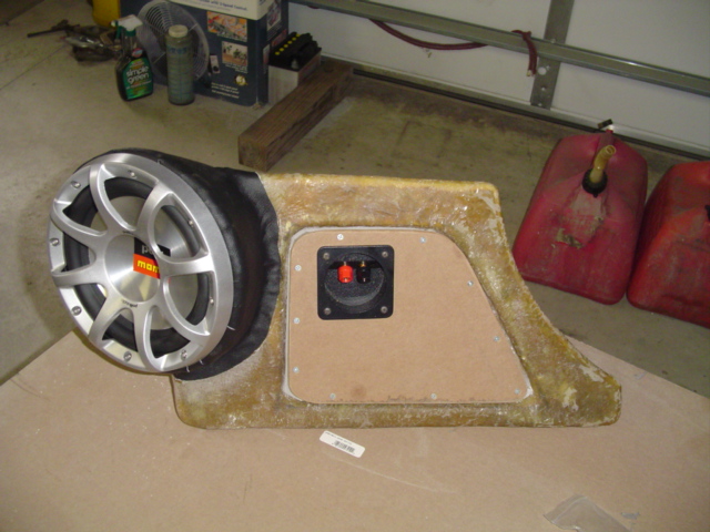

8" ?
what's the internal volume?
Looks about right for a small box sealed 8" I have, and I hate working with fiberglass (IMG:style_emoticons/default/beerchug.gif)

Chris914n6   8" ? what's the internal volume? Looks a...   Feb 10 2020, 01:26 PM
horizontally-opposed   http://www.914world.com/bbs2/uploads/post-2058-1...   Feb 10 2020, 02:01 PM
Chris914n6   [quote name='Chris914n6' post='2784795' date='Feb...   Feb 10 2020, 04:17 PM
