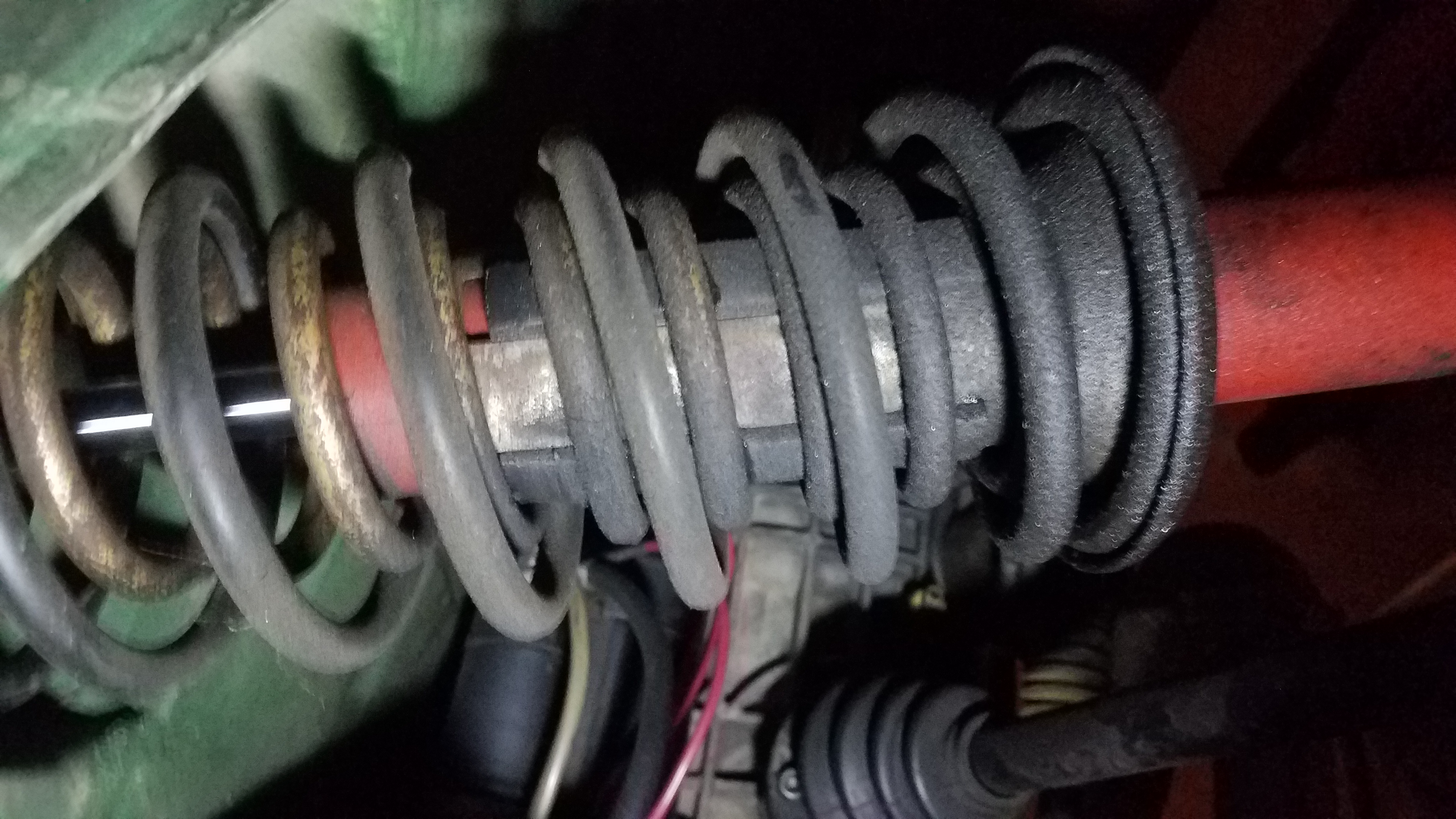

AZBanks   Dual Coil springs?? Has anyone seen this setup be...   Feb 10 2020, 09:11 PM
AZBanks   ..   Feb 10 2020, 09:12 PM
AZBanks   I am trying to replace all the old, worn out bushi...   Feb 10 2020, 09:30 PM
