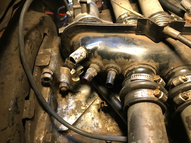

Hi - so I'm just preparing for my maiden voyage - the car must have been off the road for at least 10 years judging by the rust in the floor when I got it in June. I've changed the fan belt this morning, but there are a few thingsI saw that I think need tidying. Its got a mid mounted progressive weber (yes I know), and there looks to be a port on each side near where the headers meet the tin - should some pipes be connected to these please? Also in one photo showing the port on the passenger side there is a wire coming out of the tin with a female spade connector - you can see it in the photo. There is also a green with red trace wire coming out of the loom near the distributor which isn't connected to anything.
The car runs, but not well. Not sure how far I will get down the road!
Thanks, Dylan

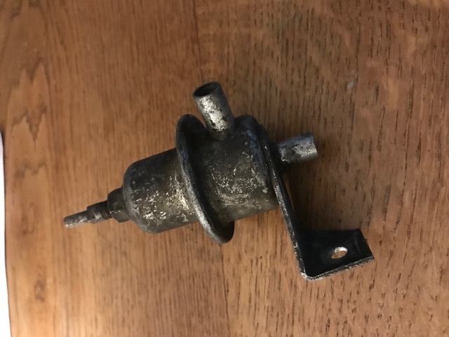

Hi! That photo has been really helpful and there is progress but I'm just struggling to see where a couple of last connections go please. On the photo below I have 3 ports - I'm not sure about the right hand one - maybe oil filler breather? Bottom left I think is MPS, top left I seem to have written "Aux Air" but can't remember where I got that info now. Also on the other photo what is this item please? Aux air valve maybe? Where does the other pipe from it go to please if so?
Many thanks! Dylan

ClayPerrine   Those two open ports are cylinder head vents. You ...   Feb 9 2019, 08:40 AM
isdyl   Thanks very much! Those two open ports are c...   Feb 9 2019, 09:05 AM
isdyl   Those two open ports are cylinder head vents. You...   Feb 13 2020, 12:33 PM
isdyl   Those two open ports are cylinder head vents. Yo...   Feb 14 2020, 07:28 AM
ClayPerrine   [quote name='isdyl' post='2785648' date='Feb 13 2...   Feb 14 2020, 08:13 AM
isdyl   [quote name='isdyl' post='2785648' date='Feb 13 ...   Feb 14 2020, 11:14 AM

rjames   Last pic is of the decel valve. Mounted on the sa...   Feb 11 2020, 06:13 PM
isdyl   Last pic is of the decel valve. Mounted on the s...   Feb 12 2020, 01:16 AM
cwpeden   Check this thread for hoses. I think you have AAR ...   Feb 14 2020, 08:42 AM
isdyl   Check this thread for hoses. I think you have AAR...   Feb 14 2020, 11:27 AM
