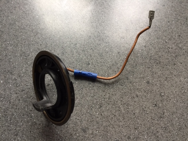

So I had a aftermarket wheel on my car when I bought it 12 years ago, and about 1-2 years into my ownership I scored an Ebay deal $50 for a very nice wood wheel that is now in the car. I have been looking for a nice original wheel for a long time and recently was able to acquire one. So as I look at the OEM one it looks like I am missing the horn button, a canceling ring possibly too. not sure what else, a spring maybe? if anyone has pictures it would be helpful.
What I currently have is the Nardi wood one that is attached to the stock column. it is metal, about 3" long, and then the wheel screws to that and the rubber center cover goes over it and the wire pulls thru and is clipped to the center hole button.
My new OEM ones has a very nice center horn part, and I did read about the counter clockwise turn to remove that. it looks like it will slide onto the spined shaft once I take the spacer/mount off that is on there now, and just bolt on the stock wheel?
I guess I need to know in what order the parts go back on. Where does the canceling ring etc go ?
I pulled up one factory diagram and that kind of gives me an idea, and SMC has the rebuild kits with a horn button, spring, and rubber center piece that goes in there. but I have not seen all this assembled, so some guidance is requested.

No spring or horn plunger on a mid or late car. You use a plastic hub with a plastic signal cancel ring that also has the wire for the horn to connect with the steering wheel bat wing. You do need the black rubber cone. You also want to make sure the bat wing has the correct metal bracket with a little tab to connect the horn wire. Early does not, mid and late do.

DRPHIL914   No spring or horn plunger on a mid or late car. Y...   Feb 12 2020, 01:01 PM
DRPHIL914   This? Ok   Feb 12 2020, 01:03 PM
mepstein   This? Ok Yes. I have an extra plastic hub if you...   Feb 12 2020, 01:17 PM
DRPHIL914   This? Ok Yes. I have an extra plastic hub if yo...   Feb 12 2020, 01:46 PM

DRPHIL914   Also the 2 end tabs of the spring thing look bent,...   Feb 12 2020, 05:39 PM
mepstein   So good news. You have the correct hub and batwing...   Feb 12 2020, 05:46 PM
FlacaProductions   Looks like you may need this as your horn wire tab...   Feb 12 2020, 05:56 PM
mepstein   Looks like you may need this as your horn wire ta...   Feb 12 2020, 06:04 PM
DRPHIL914   [quote name='FlacaProductions' post='2785389' dat...   Feb 12 2020, 09:21 PM
DRPHIL914   Looks like you may need this as your horn wire t...   Feb 13 2020, 09:49 AM
rhodyguy   Mark Heard had found the little white plastic wash...   Feb 13 2020, 11:26 AM
mepstein   Mark Heard had found the little white plastic was...   Feb 13 2020, 11:51 AM
DRPHIL914   Mark Heard had found the little white plastic wa...   Feb 13 2020, 12:06 PM
DRPHIL914   Mark Heard had found the little white plastic was...   Feb 13 2020, 12:05 PM
