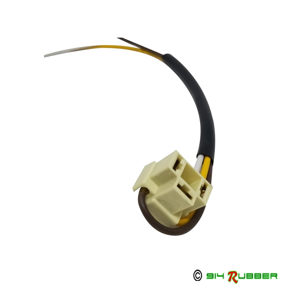

Three years ago when LED headlights started being offered for 914 I bought a set from Vintage lighting. This week The driver side headlight started blowing a fuse every time the lights were turned on. I switched out to a sealed beam light and it works fine. So that LED bulb must’ve gone bad. I looked at the $99 replacement bulb set at 914 rubber and there’s a statement that says if you have fog lights be sure and add a load to make them work. So if I go that route how do I add a load? I am also considering buying the new complete LED 7” headlight set that says plug and play as an entire unit. Will I run into the same problem with that unit?

What we are discussing is toward the end of the thread.
http://www.914world.com/bbs2/index.php?sho...+light+-working
1st thing I'd do is pull the vintage ones and make sure its that the problem is. Ours works the same way theirs does, and the draw will be similar. If you had no problems with theirs as far as fogs go, ours will be the same.
You may find theirs has not failed and the problem is a short somewhere along the wiring. I have the new 3 prong connectors ( I suspect this is your problem).
The LEDs should be good for 10,000 hrs, so unless you do a LOT of night driving it should not have failed.
https://900designs-container.zoeysite.com/t...-housing-3-pole
If not I can get you a new set. Ours now have a much better sealing rings and there is no separate ballast, it's built in.
