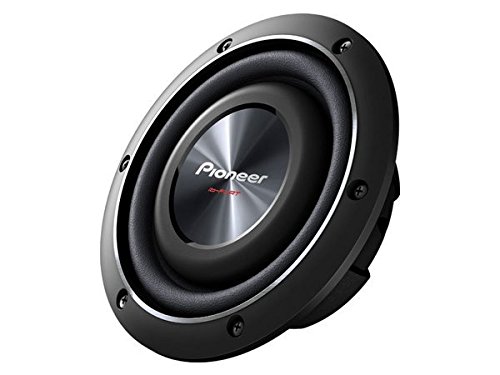

Another idea...shallow-mount Pioneer sub designed to operate in free air, for $72, at 7 inches in diameter by 2.63 inches deep.
https://www.amazon.com/Pioneer-TS-SW2002D2-...DXFFCC5Y4861TVM
Curious to hear others' thoughts on this...or whether 914rubber's setup might even enhance this? The idea of a sub in place of the footrest foam—without losing any legroom—remains highly appealing.

horizontally-opposed   Another idea...shallow-mount Pioneer sub designed ...   Feb 15 2020, 07:58 PM

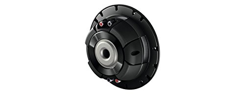

horizontally-opposed   Also interesting, at $92… https://www.amaz...   Feb 15 2020, 08:37 PM
