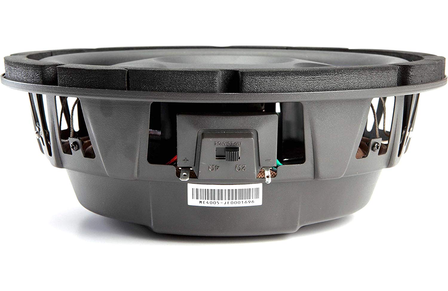

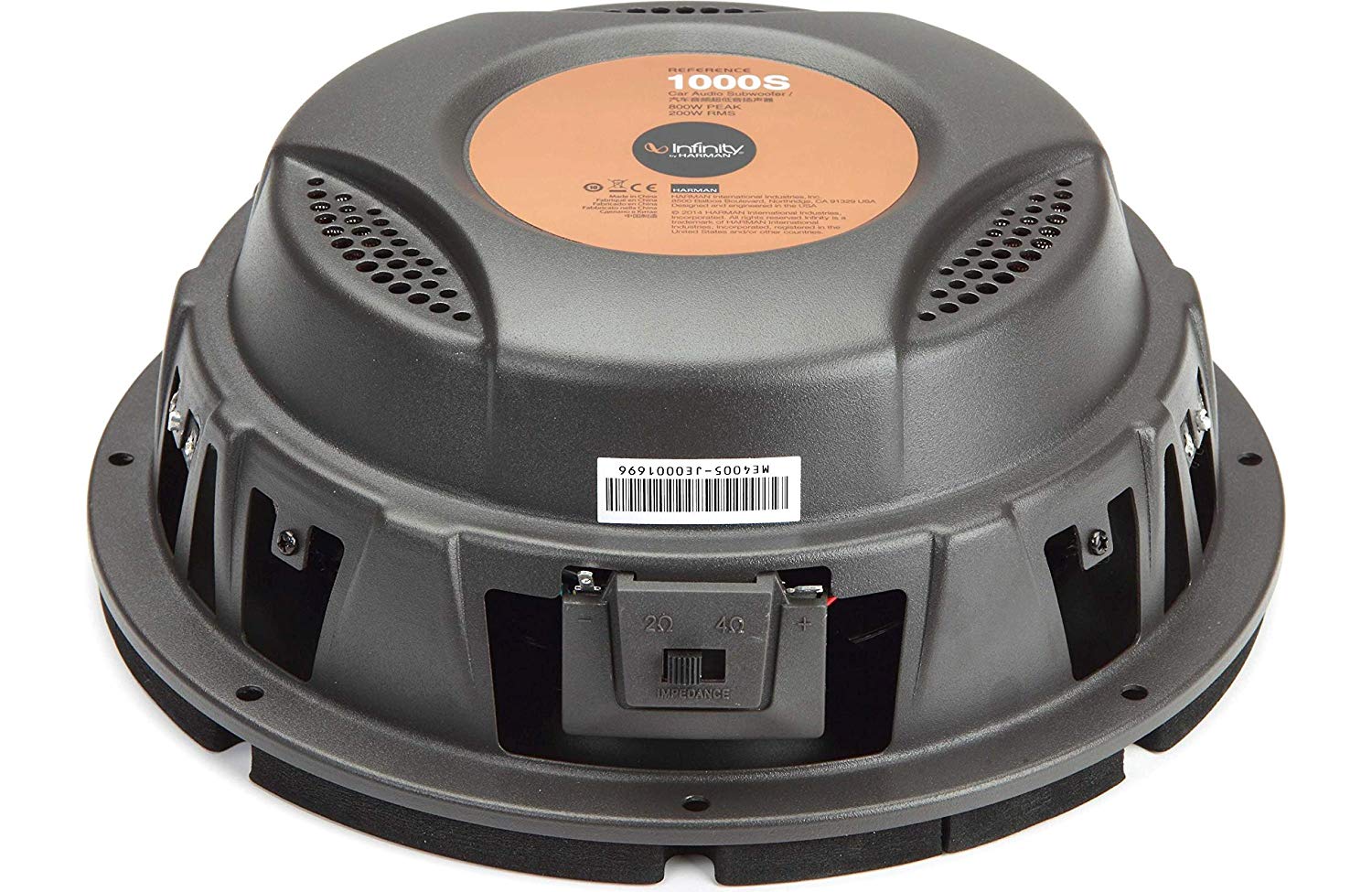

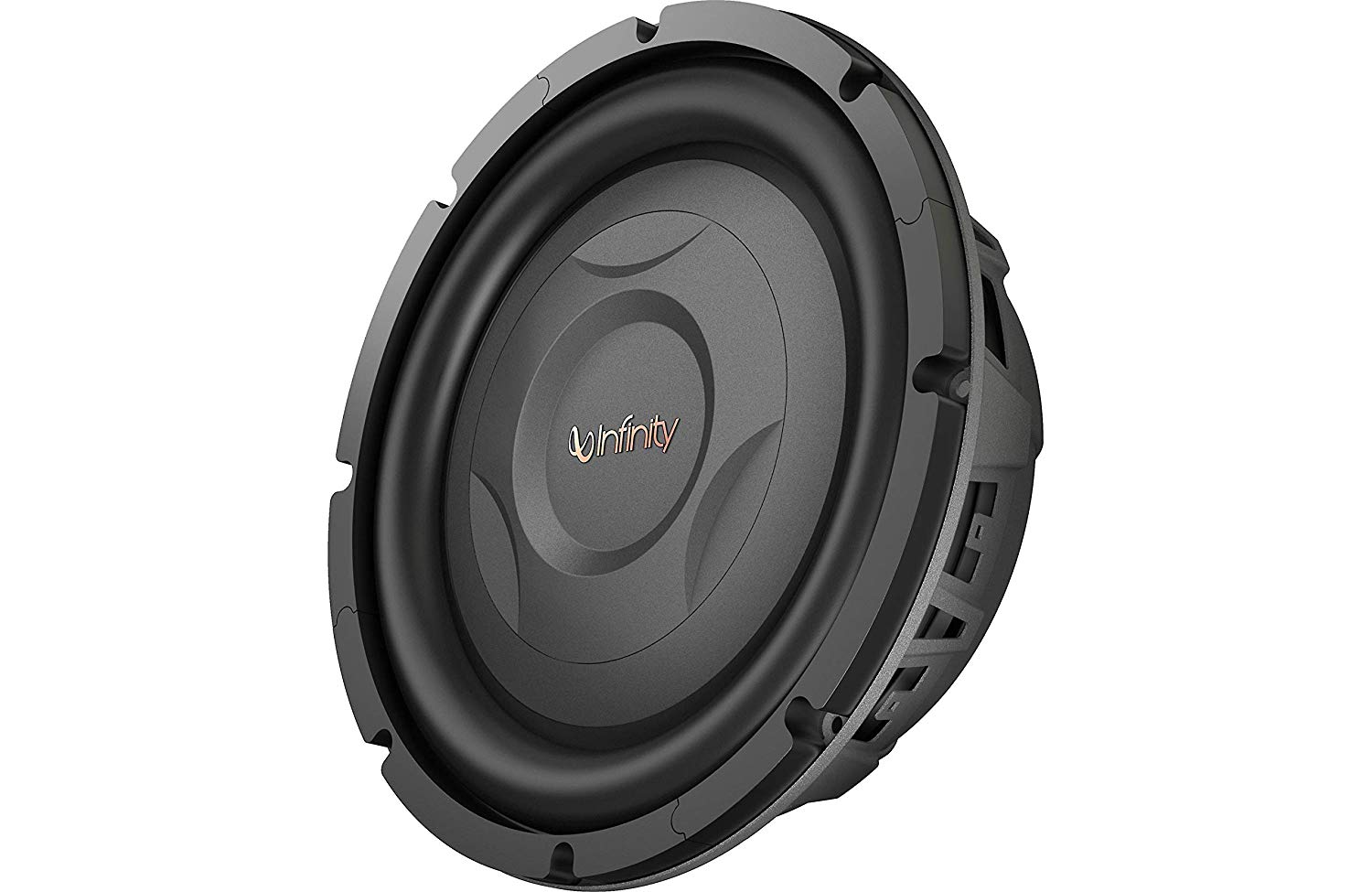

horizontally-opposed   Another idea...shallow-mount Pioneer sub designed ...   Feb 15 2020, 07:58 PM
horizontally-opposed   Also interesting, at $92… https://www.amaz...   Feb 15 2020, 08:37 PM
914forme   the 12" version of the infinity gets really g...   Feb 16 2020, 05:27 PM
