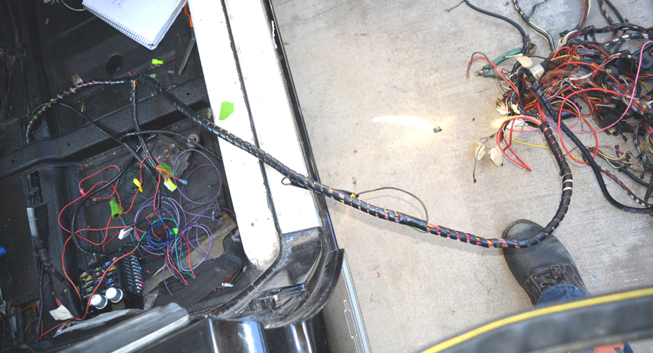

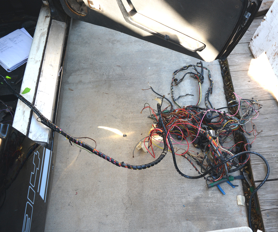

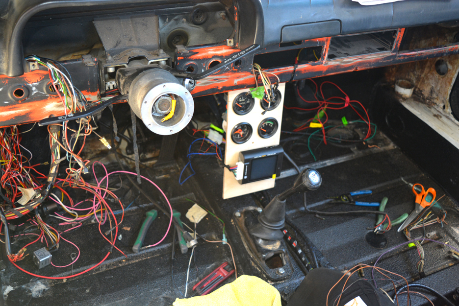

Thank you Andy!!!!! I am working on a 73 V8 conversion and had to run another harness through the car. Your labeling of the harness will help with some of the "what are these and where do they go "?'s" I have.
Still not sure how to tie-up/mount the bundle of wires near the fuse panel.
This is with the harness in the engine bay done and up to the shifter.
This is with harness through front bulkhead and the rats nest zip tied up waiting for stuffing and hook up.

QUOTE(Daryl32 @ Feb 19 2020, 06:44 AM) *
@Daryl32
There should be metal tabs on the body going up to that area to help keeping the harness in place.
