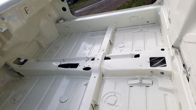

Perfect timing. Taylor just shot some color on the car so he can get it off the rotisserie. The final paint will be shot once most of the work is done. We were just looking at the harness he took out and this is a great reference.
Thanks again Andy
