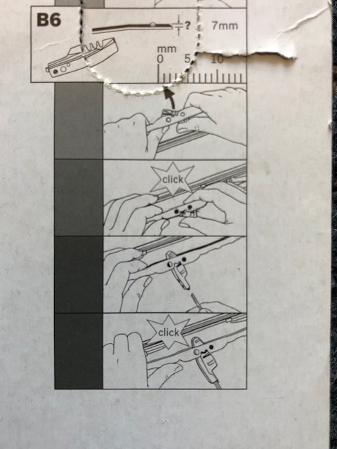

@eric9144
Not sure those are going to work as those are the ones I ordered. You can see from the attached pics that the B6 attachment for 7mm is for a straight arm at the tip and not a hook. Regardless, let me know should you achieve success.
