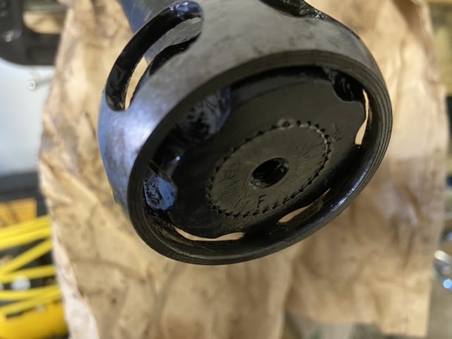

I am cleaning up some axles and re-lubing cv’s
first axle, first cv popped off the half shaft with just a few good tugs per cuddyk’s youtube how to
first axle, second cv cannot get the spider and cage off the axle
started with tugging and pretty soon the balls and outer cylinder were in my hands but spider and cage still on half shaft
moved to hammer & punch working around the back side perimeter of conical washer up against the spider got some movement but slow and seemed to stop with about a 16th of an inch of the half shaft grooves still proud of the outboard side of the spider
I was spraying with wd-40 intermittently all the while
next borrowed a slide hammer and puller plate from o’reilly maybe got a little more progress but still see grooves proud of the outboard side of the was spider
I’ve soaked it over night with wd-40 and will hit it again with the puller/slide hammer this afternoon
Any other suggestions? l don’t have a torch here but I’d be hesitant to use one on the spider anyway
TIA

small progress
decided the slide hammer wasn’t doing any better than a hammer and punch so returned that and worked with hammer and punch for awhile
still no torch or file available but l punched it back and forth and have at least gotten it to flush
l figure at most 16 more afternoons & I’ll have it free!
