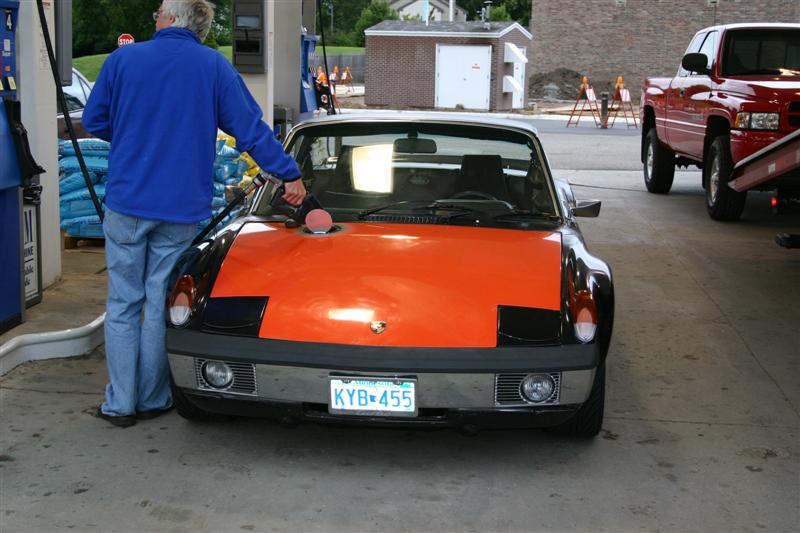

Did this about 13 yeras ago, fuchs center cap, Knurled alum. adapter, pressed on early fuel cap. Beats opening the hood.

Actually I find I have better control of the fuel hose over the top than under, which has the ability to mar the top of the fenders paint. After installing one in the hood I prefer it, its way more convenient plus I was going for that 914 6 gt turbo carrera look. You can get locking or solenoid release fuel doors also if you need it to be secure. Here is a picture Qarl took of me last summer fueling up, as you see in the picture i wasn't being to careful worrying about the paint, next summer will be different after the cars beauty makeover.

iamchappy   here is a pic of my install   Dec 10 2004, 09:48 AM

ClayPerrine   Not being critical, but asking a question. Why d...   Dec 10 2004, 11:20 AM
iamchappy   Actually I find I have better control of the fuel ...   Dec 10 2004, 01:22 PM
Howard   :agree: Have one on V8 car. Flares, wing, yada, ...   Dec 10 2004, 03:09 PM
