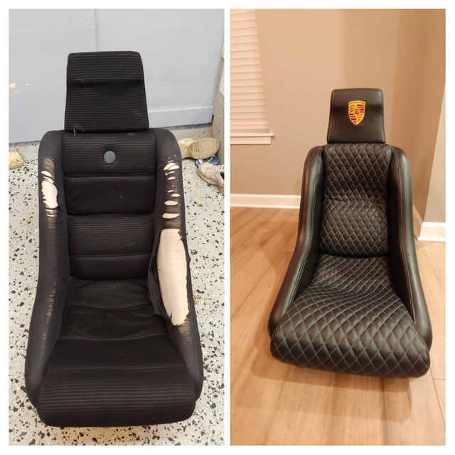

R Dub
post Feb 28 2020, 09:43 PM
Posts: 126
Joined: 29-August 17
From: Burbs of Chicago
Member No.: 21,387
Seats are done. What a difference. Start to put the interior back together tomorrow
(IMG:http://www.914world.com/bbs2/uploads_offsite/i.ibb.co-21387-1582947784.1.jpg)
