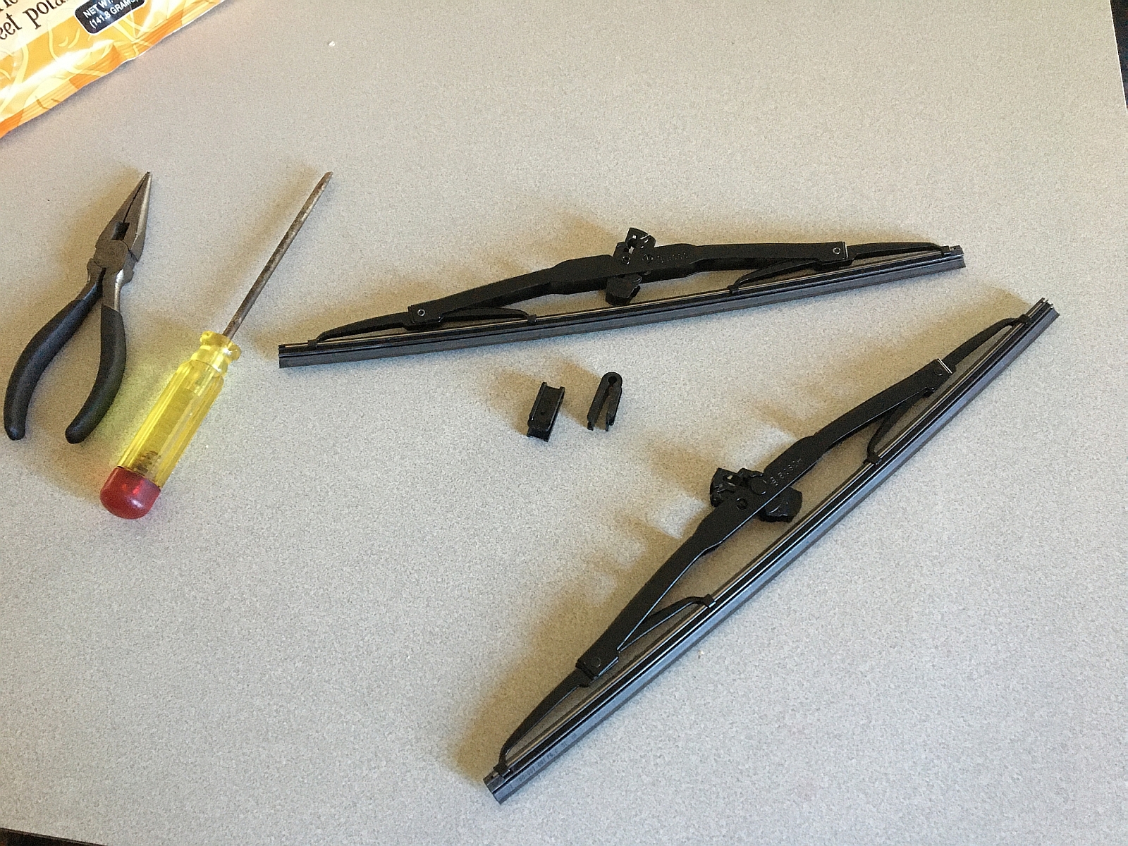

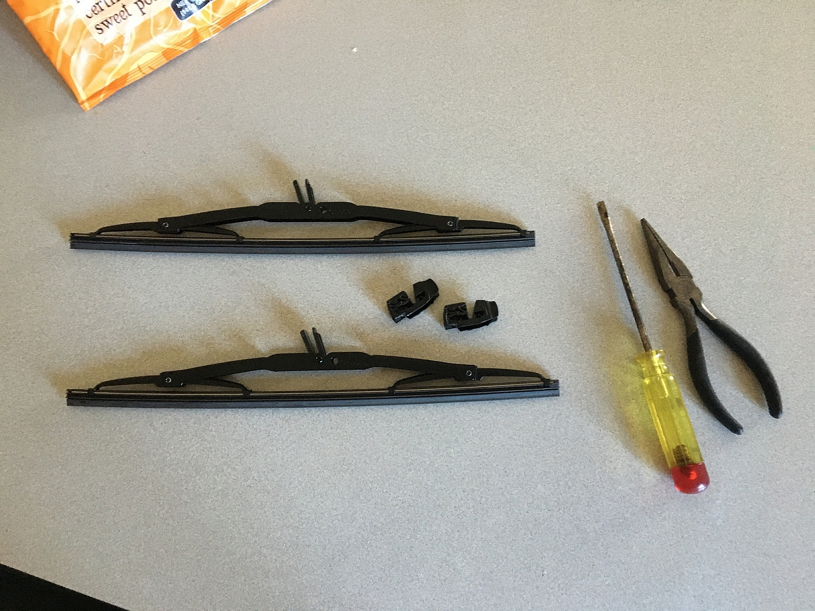

Mark Henry   If you have the new bosch blades I may have figure...   Feb 29 2020, 04:49 PM
Mikey914   WOW Should we really have to modify wiper blades t...   Feb 29 2020, 06:13 PM
bbrock   WOW Should we really have to modify wiper blades ...   Feb 29 2020, 09:24 PM
914_7T3   WOW Should we really have to modify wiper blades...   Feb 29 2020, 11:36 PM
Mikey914   Yes if there is a solution that looks stock no nee...   Mar 1 2020, 02:04 AM

bbrock   Here are the clips I just took off my 30+ year old...   Mar 3 2020, 09:09 AM
914_7T3   V..........Victory!   Mar 8 2020, 06:09 PM
FlacaProductions   So...what was the final answer?   Mar 8 2020, 06:38 PM
914_7T3   So...what was the final answer? Found them at o...   Mar 8 2020, 08:06 PM
