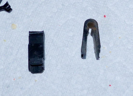

My last batch of new 13" Bosch blades will not work (properly) on 914 and 911-912 wiper arms. They now only have clips for 9mm arms. Any solutions?? Thanks, Brad

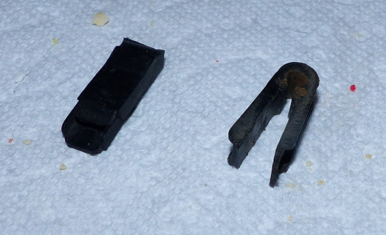

Here are the clips I just took off my 30+ year old Bosch wiper holders. Same as the clips in Johnny Blacktain's pic above. Of course, the one on the left was brittle and shattered (IMG:style_emoticons/default/headbang.gif)
