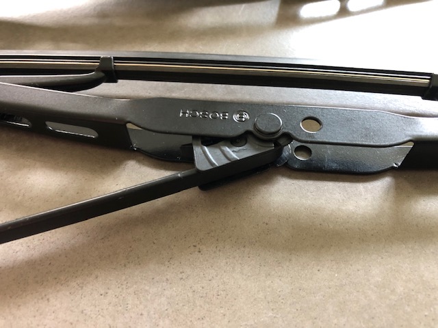

914_7T3   Resurrecting this thread as my new Bosch wiper bla...   Feb 24 2020, 08:06 PM
914ltd   I found these Trico blades. 13" black 7mm arm...   Feb 25 2020, 10:48 AM

bbrock   These adapters look interesting: https://smile.ama...   Feb 25 2020, 08:01 PM
914_7T3   These adapters look interesting: https://smile.am...   Feb 26 2020, 02:36 PM
bbrock   [quote name='bbrock' post='2789167' date='Feb 25 ...   Feb 26 2020, 03:58 PM
914_7T3   [quote name='bbrock' post='2789167' date='Feb 25...   Feb 26 2020, 04:20 PM
914_7T3   [quote name='bbrock' post='2789167' date='Feb 25 ...   Mar 2 2020, 11:09 PM
bbrock   [quote name='bbrock' post='2789167' date='Feb 25...   Mar 2 2020, 11:23 PM

914_7T3   Add these POS blades to the list with Bosch that d...   Feb 26 2020, 02:31 PM

Mark Henry   If you have the new bosch blades I may have figure...   Feb 29 2020, 04:49 PM

914_7T3   Anybody know if this is the correct clip? If so, ...   Mar 2 2020, 11:32 PM
DRPHIL914   Anybody know if this is the correct clip? If so,...   Mar 3 2020, 08:03 AM
bbrock   Here are the clips I just took off my 30+ year old...   Mar 3 2020, 09:09 AM
