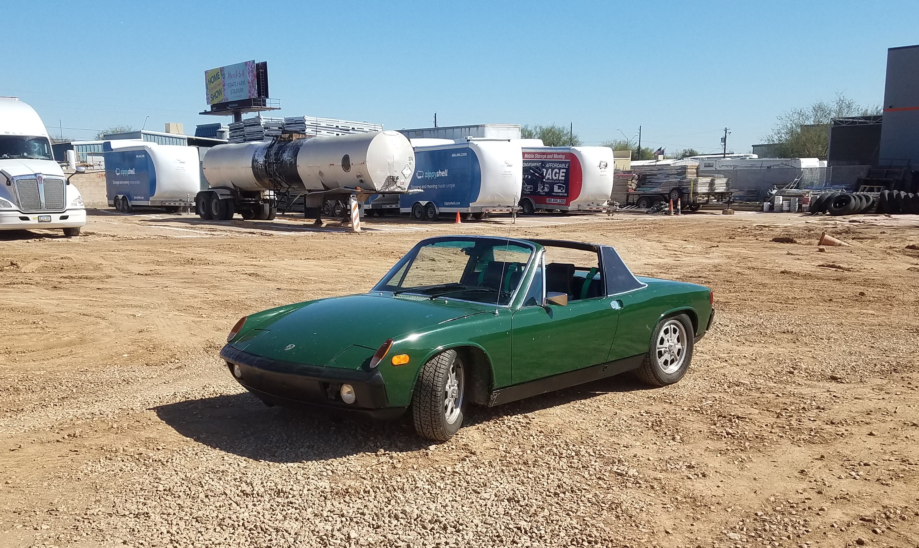

I got what turned out to be a dead end lead on another 914 for sale.
I did get a nice picture of my car out of the deal so it wasn't a total loss.
My son is out of school for at least two weeks and I have no work for two weeks so I guess we will get to some work on the car.
