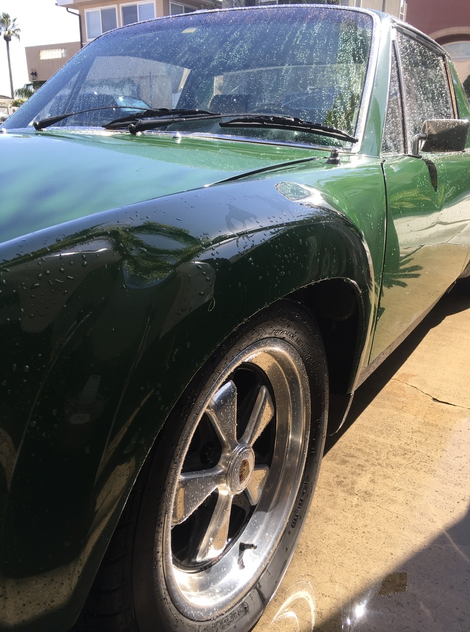

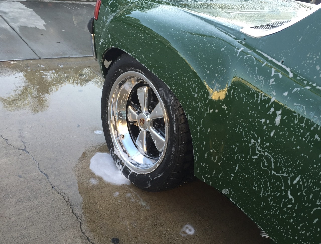

On stock Porsche Fuchs wheels I’m running tires that are.
225/50- 16 front
245/45- 16 rear
I’ve got tons of room on the front Porsche factory steel flare, like 2-1/2 inches..!
Fuch wheels
8/16
9/16
* Part Numbers: 951.362.117 and 911.362.119
* Set of Four 16" Fuchs Wheels
* 8" and 9" in Width
* 8" Offset of ET 23.3
* 9" Offset of ET 15
* 4585 & 4885 Date Stamps (Front)
* 1002 Date Stamps (Rear)
