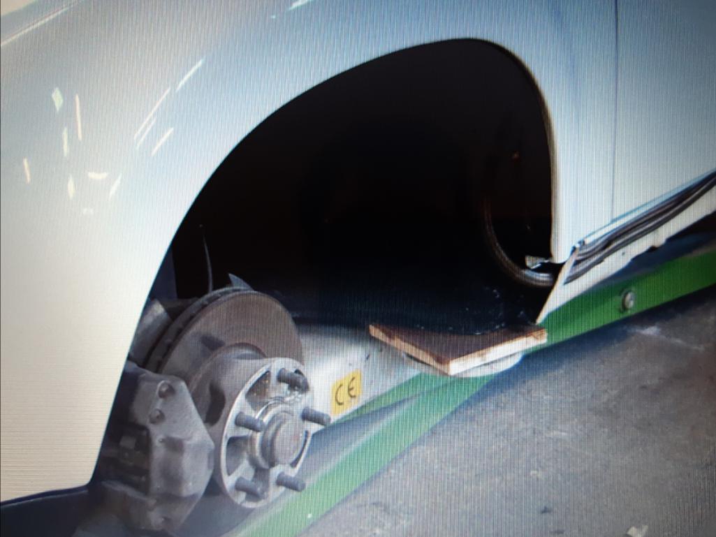

Based on the responses, the fact the rear donuts / surrounding floorpan on my car look fine, and noticing from a picture I took where my garage jacked the car at the front I will jack it on the rear donut with a spreader plate and a spreader plate in the front corner behind the wheel arch:
