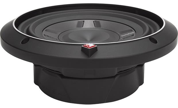

Thought I would report that the JL Audio sub mentioned earlier in this thread does NOT fit as a stealth installation. The magnet is just about 1/4" too large in diameter to fit into the footwell foam space. If you are willing to give up about an inch of footwell space, it would work, but I'm not. I'm sending mine back and will get one of these instead:
(IMG:http://www.914world.com/bbs2/uploads_offsite/images.crutchfieldonline.com-20845-1585284551.1.jpeg)
https://www.crutchfield.com/p_575P3SD28/Roc...8.html?tp=68847
The JL sounded really nice though. Even just using a cardboard box for an enclosure, it paired very nicely with my Infinity speakers.
@Mikey914 Any progress on those enclosures? Will there be a sealed enclosure option? I'm guessing the port could be sealed up easy enough, but curious.
