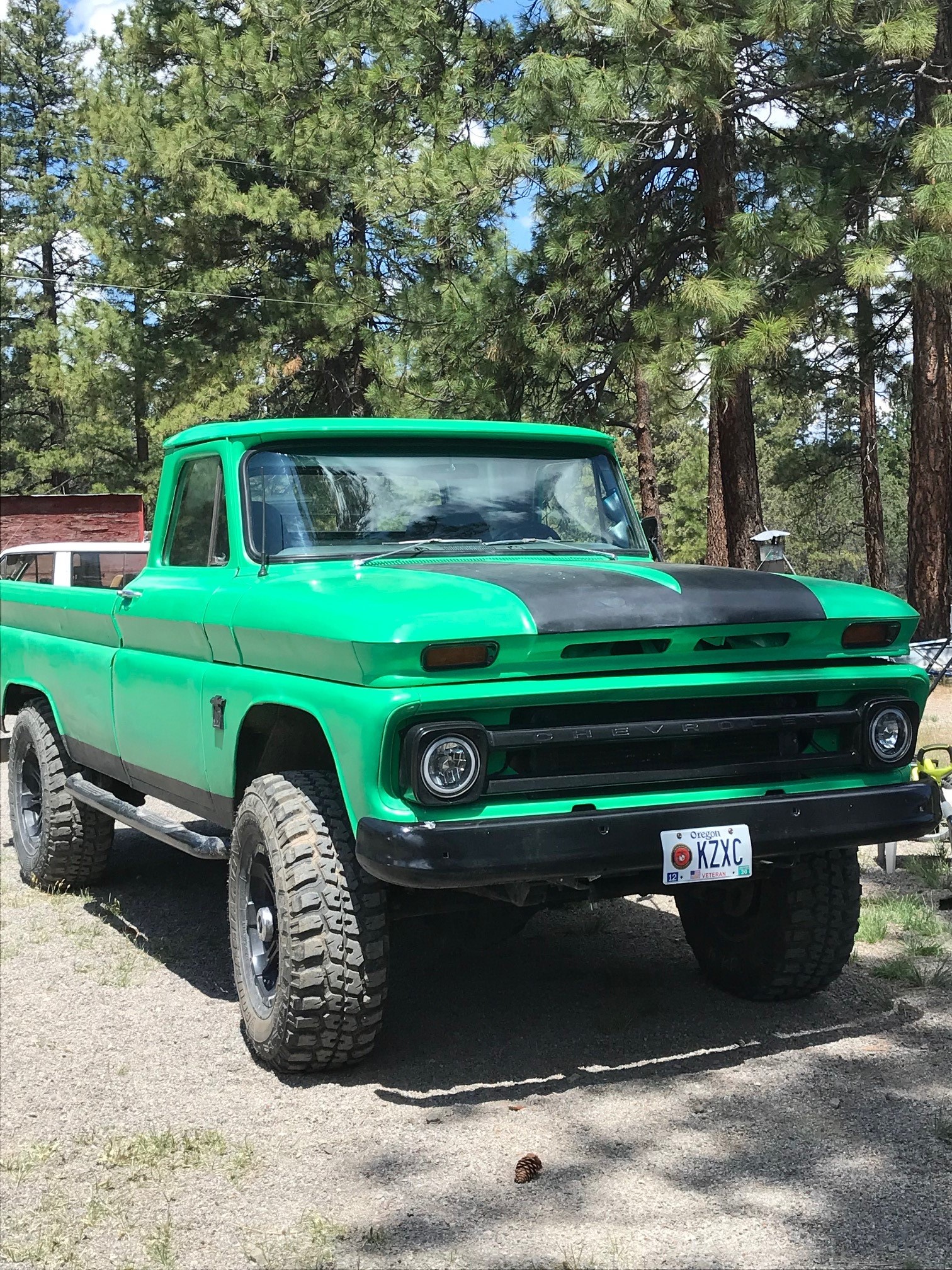

more cummins pics..finished truck about 11 months...truck is updated with all the stuff from the dodge to included gauges.

lastwolf69   pics of the cummins conversion in case anyone was ...   Apr 7 2020, 10:06 AM
lastwolf69   more cummins pics..finished truck about 11 months....   Apr 7 2020, 10:08 AM
lastwolf69   heading to the car show   Apr 7 2020, 10:13 AM
