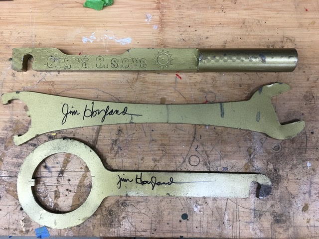

What tool do I use to tighten this special nut? Instructions say torque to 95 ft-lbs.
I do NOT want to mess it up with a pipe wrench!
I could not find a tool on Pelican's site or anywhere else.
Is this it:
Am I looking for a gland nut removal tool?

I have the tool and you are welcome to use it. It was made by a member who made thrm
This what you need ?

Thanks! (IMG:style_emoticons/default/beerchug.gif) Looks like I need the middle one, correct? I sent a PM to you, but let me check with my in-laws; my FIL might have a bike wrench.
