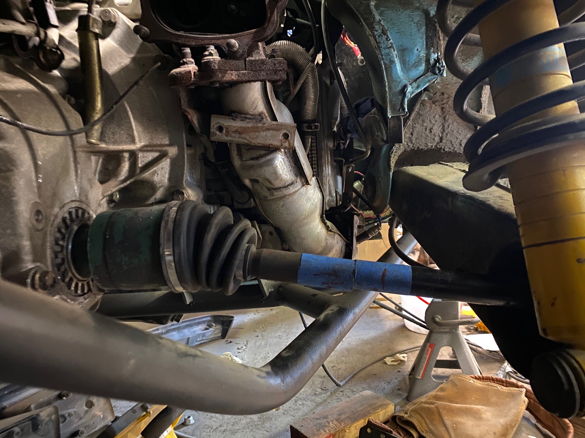

first axle test fit...need to take about 1.25" off still...gonna order some custom made ones from sway-a-way next week if anyone needs a set now is the time more people who buy them at once the cheaper the price gets....let me know guys and gals

lastwolf69   first axle test fit...need to take about 1.25...   Apr 9 2020, 08:56 AM

lastwolf69   Just ordered new axles from sway-a-way so if any o...   Apr 16 2020, 11:23 AM
