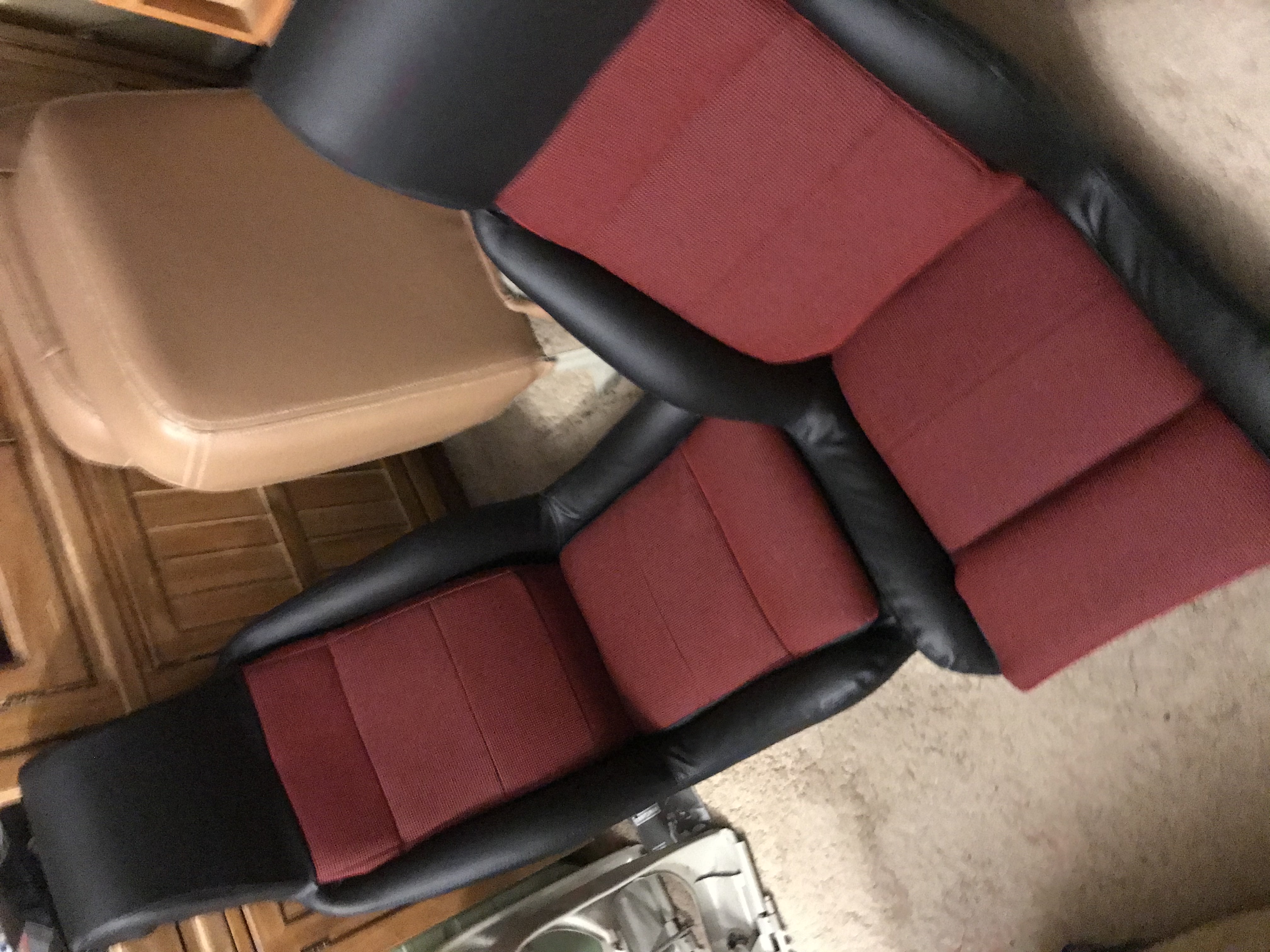

With all the rain it was lucky that I had already purchased the fabric for the seats. Nowhere near needing them yet but I was stuck inside.
I increased the bolster height and I added a lot of lumbar support. On the drivers seat I also installed an inflatable lumbar pad in case I need more (IMG:style_emoticons/default/wacko.gif)
I have not tried to heat out the wrinkles yet.
