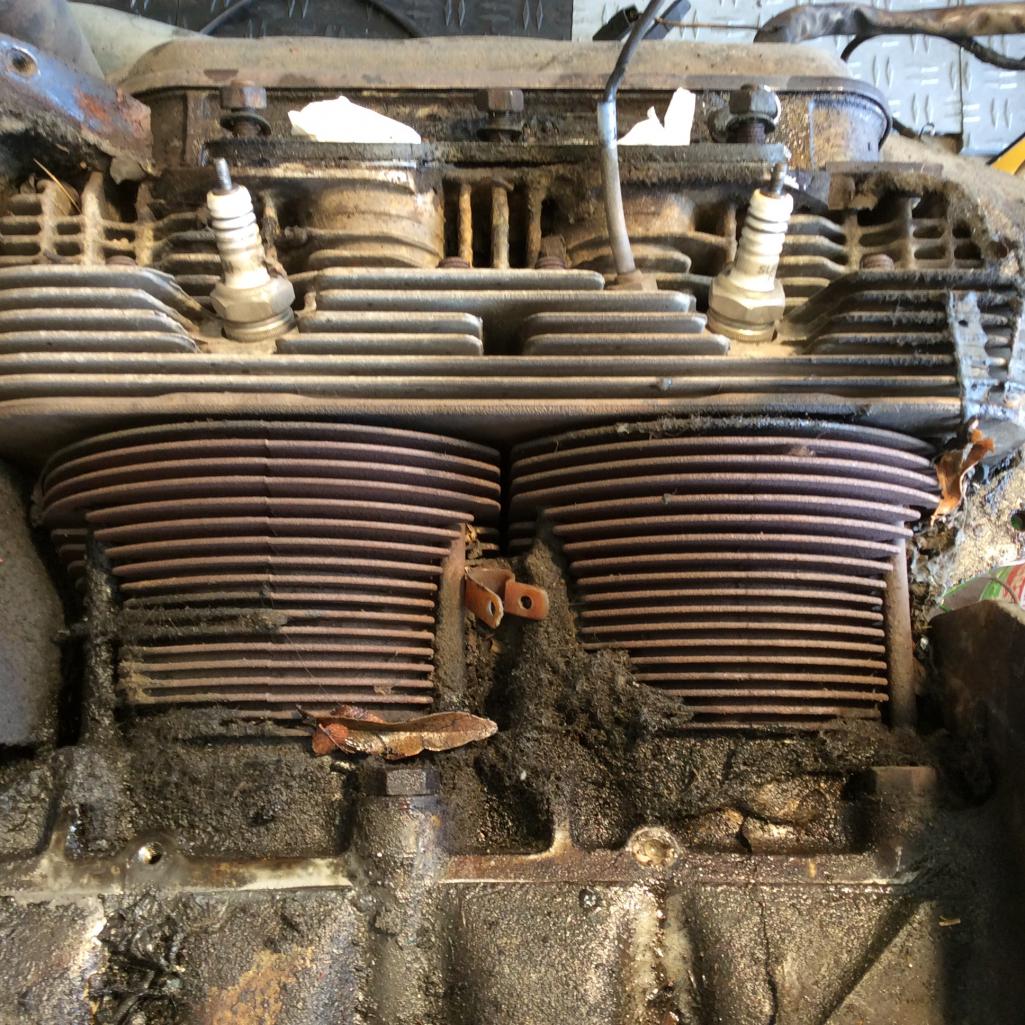

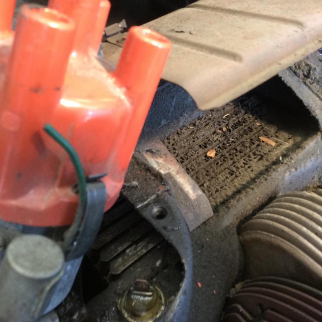

Just don’t understand why it would run hot.... (IMG:style_emoticons/default/confused24.gif)

QUOTE(loco914 @ Apr 22 2018, 02:41 PM) *
Attached Image Attached ImageAttached Image
(IMG:style_emoticons/default/lol-2.gif)

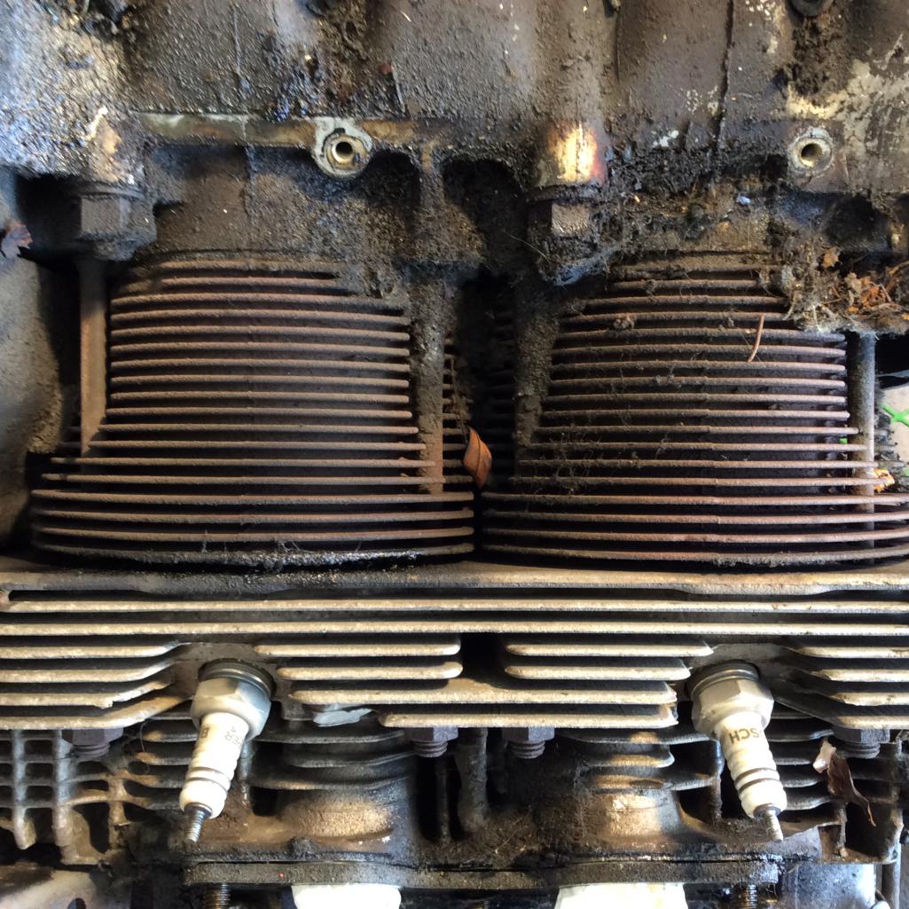

There are so many 914's out there running around with oil coolers just like this one and folks wondering why they run hot.
Great job taking advantage of the engine drop to get in there and get this stuff cleaned up. (IMG:style_emoticons/default/smilie_pokal.gif)
