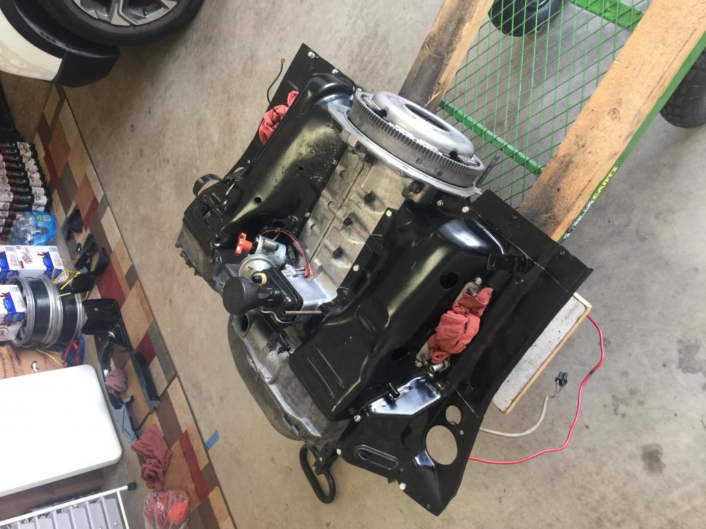

First engine/tranny drop was successful.
Pulled the clutch and found this...
The adventure begins...

loco914   Uncharted Territory   Apr 21 2018, 09:13 PM
GeorgeRud   I think you got your money’s worth out of those ...   Apr 21 2018, 10:18 PM
porschetub   That's messy,don't often see a disk do tha...   Apr 22 2018, 02:04 AM
Porschef   Throw in some SS fuel lines while the engine's...   Apr 22 2018, 06:23 AM
loco914   Here’s the flywheel. Plan to remove and have it ...   Apr 22 2018, 12:12 PM
porschetub   Here’s the flywheel. Plan to remove and have it...   Apr 22 2018, 06:00 PM
loco914   Just don’t understand why it would run hot.... :...   Apr 22 2018, 12:41 PM
Superhawk996   Just don’t understand why it would run hot.... ...   Apr 12 2020, 02:22 PM
98101   Going to do my clutch (pushrod tube seals, rear ma...   Apr 22 2018, 01:42 PM
loco914   Going to do my clutch (pushrod tube seals, rear m...   Apr 22 2018, 03:59 PM
loco914   Ok. This is hopefully as far as I will go. ...   Apr 22 2018, 05:04 PM
rgalla9146   Ok. This is hopefully as far as I will go. ...   Apr 22 2018, 05:30 PM
nditiz1   Not trying to hijack, but can someone tell me how ...   Apr 22 2018, 05:38 PM
Andyrew   Not trying to hijack, but can someone tell me how...   Apr 23 2018, 11:55 AM
Perry Kiehl   You are going to run much cooler with all the moto...   Apr 22 2018, 07:16 PM
loco914   Thanks for all the tips! Keep them coming. It ...   Apr 22 2018, 09:42 PM
Dr Evil   Don't forget the TOB and to see if you need to...   Apr 23 2018, 09:02 AM
loco914   A little progress last night and today. Got the mu...   May 5 2018, 06:55 PM
porschetub   A good clean on the housing you will be good,if yo...   May 5 2018, 11:56 PM
Amphicar770   Fun stuff. Did mine about a year ago. There are...   May 6 2018, 09:30 AM
Amphicar770   Regarding oil cooler. They are not expensive. I go...   May 6 2018, 09:53 AM
loco914   Regarding oil cooler. They are not expensive. I g...   May 7 2018, 12:45 PM
loco914   Slow, but making progress. Estimating the equivale...   May 12 2018, 01:11 PM
cuddy_k   Steam cleaner. Under 100 bucks at HF. https://ww...   May 12 2018, 02:08 PM
1adam12   I just finished cleaning my engine up. Took about...   May 12 2018, 03:02 PM
loco914   Very nice! Much needed motivation.   May 12 2018, 04:09 PM
Mark Henry   http://www.914world.com/bbs2/uploads/post-11542-15...   May 12 2018, 04:12 PM
loco914   Almost 2 years to the day, I finally have my 914 b...   Apr 12 2020, 02:18 PM
loco914   Before.   Apr 12 2020, 02:30 PM
loco914   Before.   Apr 12 2020, 02:32 PM
loco914   After.   Apr 12 2020, 02:33 PM
loco914   Before. For the 3rd time.   Apr 12 2020, 02:34 PM
loco914   Rebuilt pedal board.   Apr 12 2020, 02:38 PM
loco914   Ready to install   Apr 12 2020, 02:39 PM
loco914   All buttoned up.   Apr 12 2020, 02:40 PM
loco914   Off the ramps and ready to roll, :driving:   Apr 12 2020, 02:41 PM
