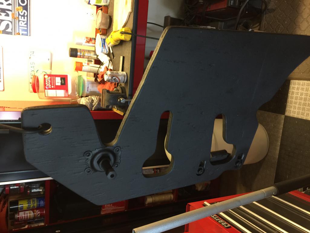

loco914
post Apr 12 2020, 02:38 PM
Thy wheels have left the rail...
Posts: 47
Joined: 1-April 10
From: Amarillo, TX
Member No.: 11,542
Rebuilt pedal board.

loco914   Rebuilt pedal board.   Apr 12 2020, 02:38 PM
loco914   Ready to install   Apr 12 2020, 02:39 PM
