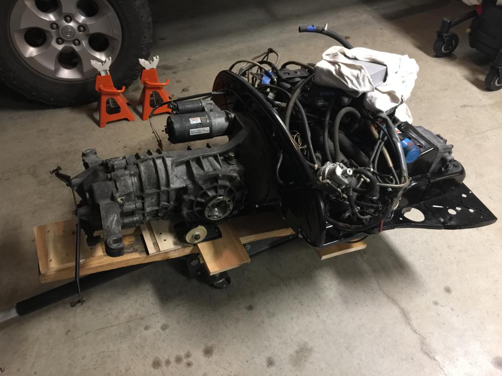

First engine/tranny drop was successful.
Pulled the clutch and found this...
The adventure begins...
