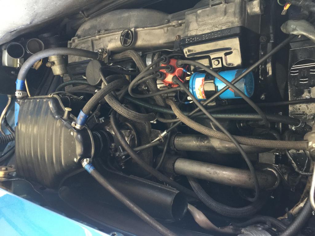

loco914   Almost 2 years to the day, I finally have my 914 b...   Apr 12 2020, 02:18 PM
loco914   Before.   Apr 12 2020, 02:30 PM
loco914   Before.   Apr 12 2020, 02:32 PM
loco914   After.   Apr 12 2020, 02:33 PM
loco914   Before. For the 3rd time.   Apr 12 2020, 02:34 PM
loco914   Rebuilt pedal board.   Apr 12 2020, 02:38 PM
loco914   Ready to install   Apr 12 2020, 02:39 PM
loco914   All buttoned up.   Apr 12 2020, 02:40 PM
loco914   Off the ramps and ready to roll, :driving:   Apr 12 2020, 02:41 PM
