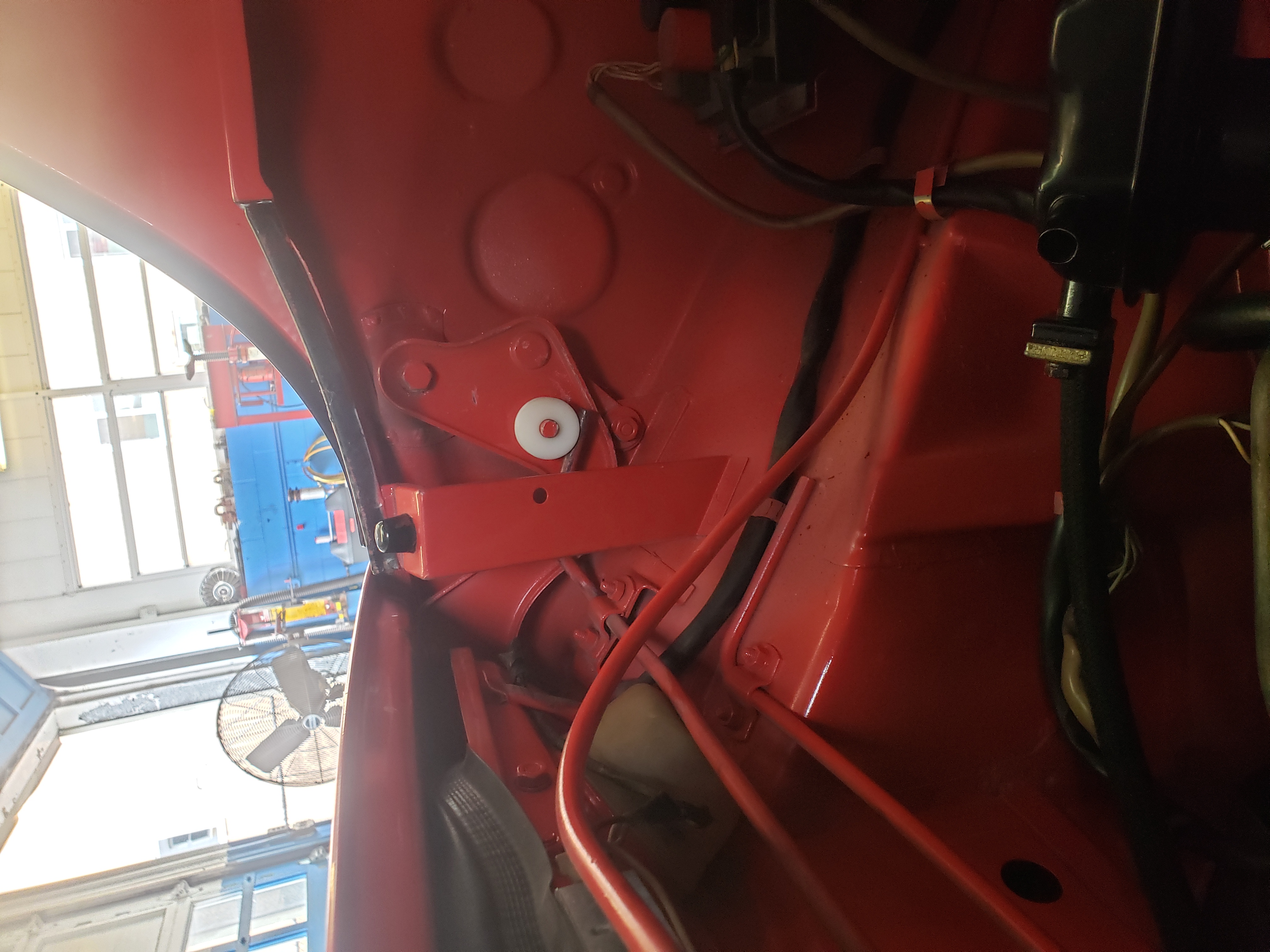

jrmdir   Older thread but Doug still deserves kudos for the...   Aug 10 2021, 08:57 AM
NARP74   Older thread but Doug still deserves kudos for th...   Aug 10 2021, 09:58 AM
ClayPerrine   How did you determine the location of the JWest b...   Aug 10 2021, 01:21 PM
tomh   I notched an old flat crow bar It worked great.   Aug 10 2021, 09:43 AM
jrmdir   How did you determine the location of the JWest b...   Aug 10 2021, 11:19 AM
jrmdir   Success! I've owned this car for over 2 m...   Aug 10 2021, 02:32 PM
