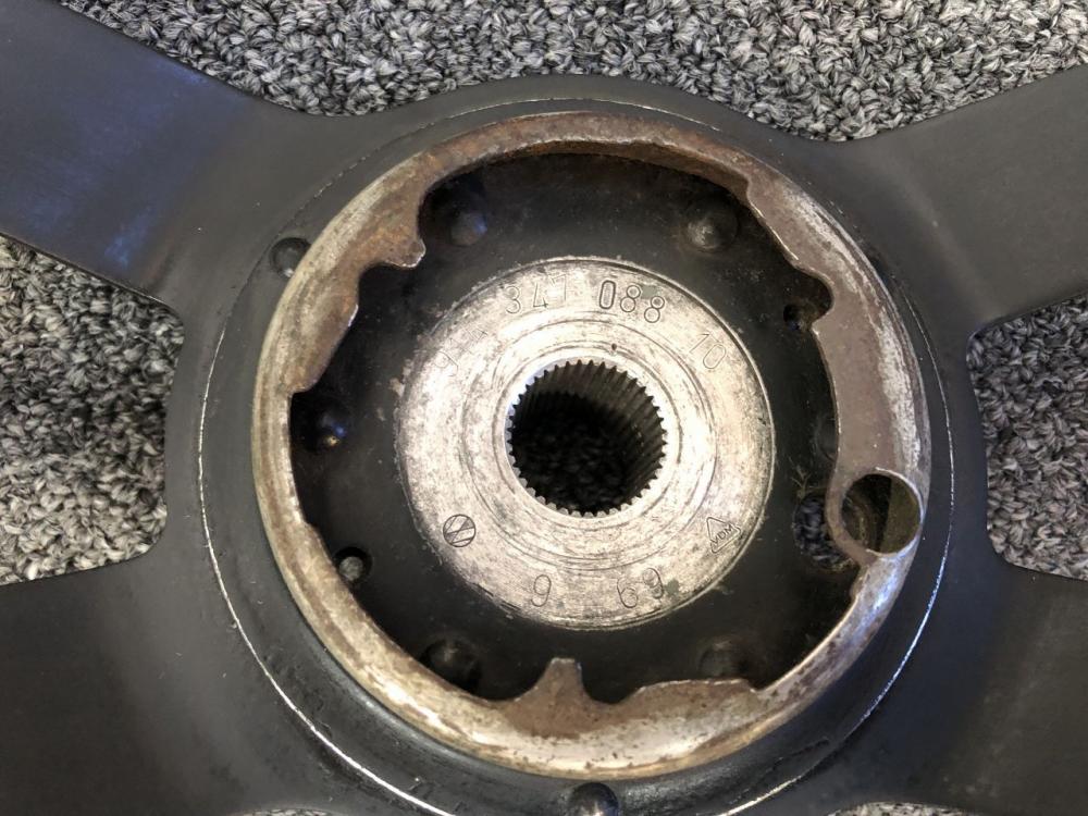

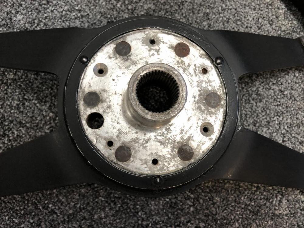

Has anyone seen an early steering wheel with part # 914.347.088.10? This one is dated 9/69 had a leather cover but it has been removed also has the "VW" logo instead of the "P" logo, flat front hub and countersunk holes for cancel ring.

QUOTE(Mike Fitton @ Apr 22 2020, 07:43 PM) *
Yes, I have one with leather and also have a 914.347.087.10 with a plastic rim. Seems to be an early version of the 804 & 805 wheel.
@Mike Fitton
