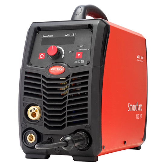

Bought new BOC 180 smootharc mig last year,real happy ,will do heavy stuff and is really good for stitching light stuff,got discount on it for $740 which in my country is a killer price.
