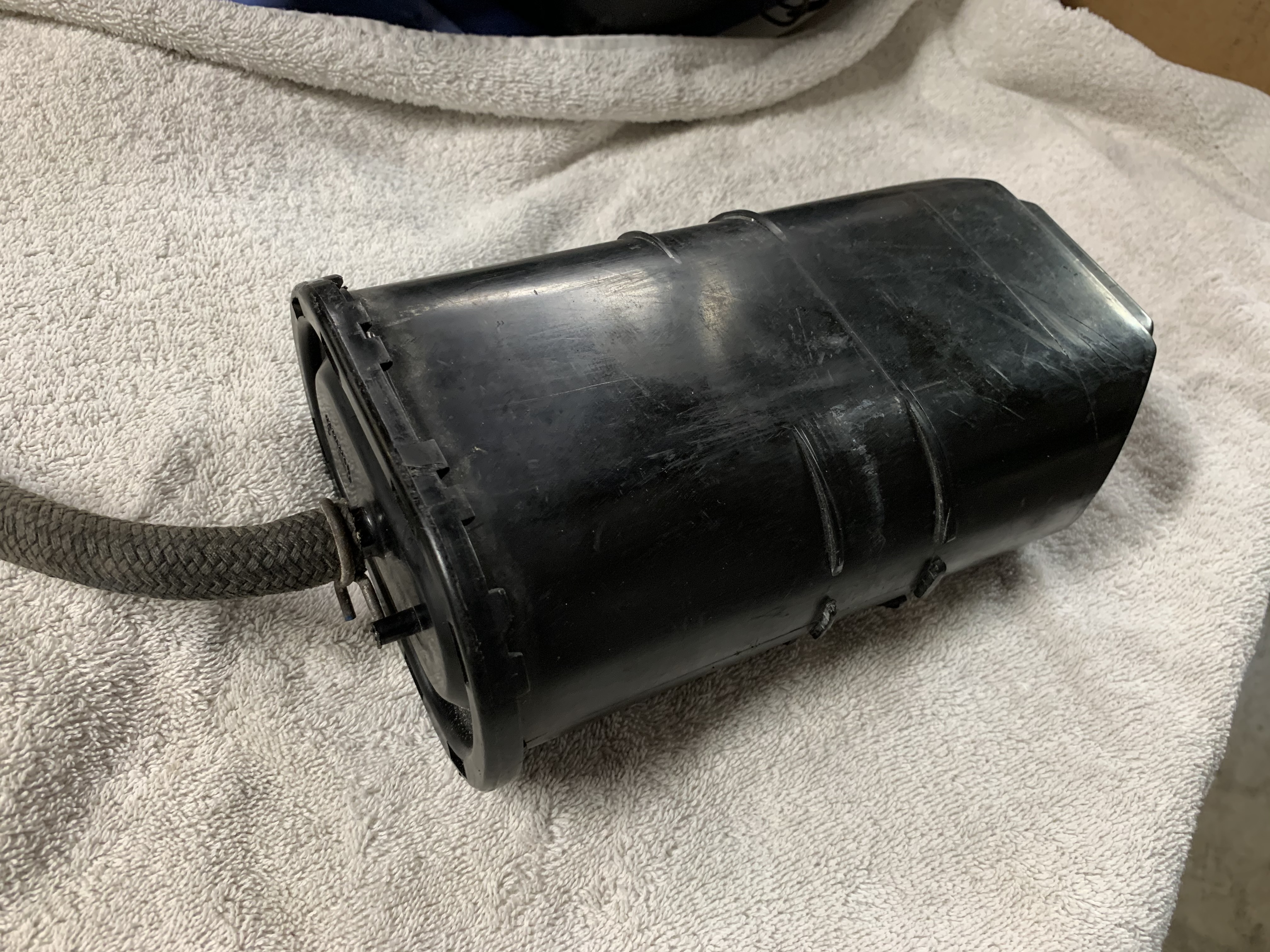

This is the plastic canister I bought and hopefully I can use the existing mounting bracket on my 73.

QUOTE(gonzo54 @ Apr 23 2020, 04:43 PM) *
-Rick
I doubt it... I thought the 73 had a metal container which is more flatter.
This plastic one is the one I have mounted between the battery and the firewall.
