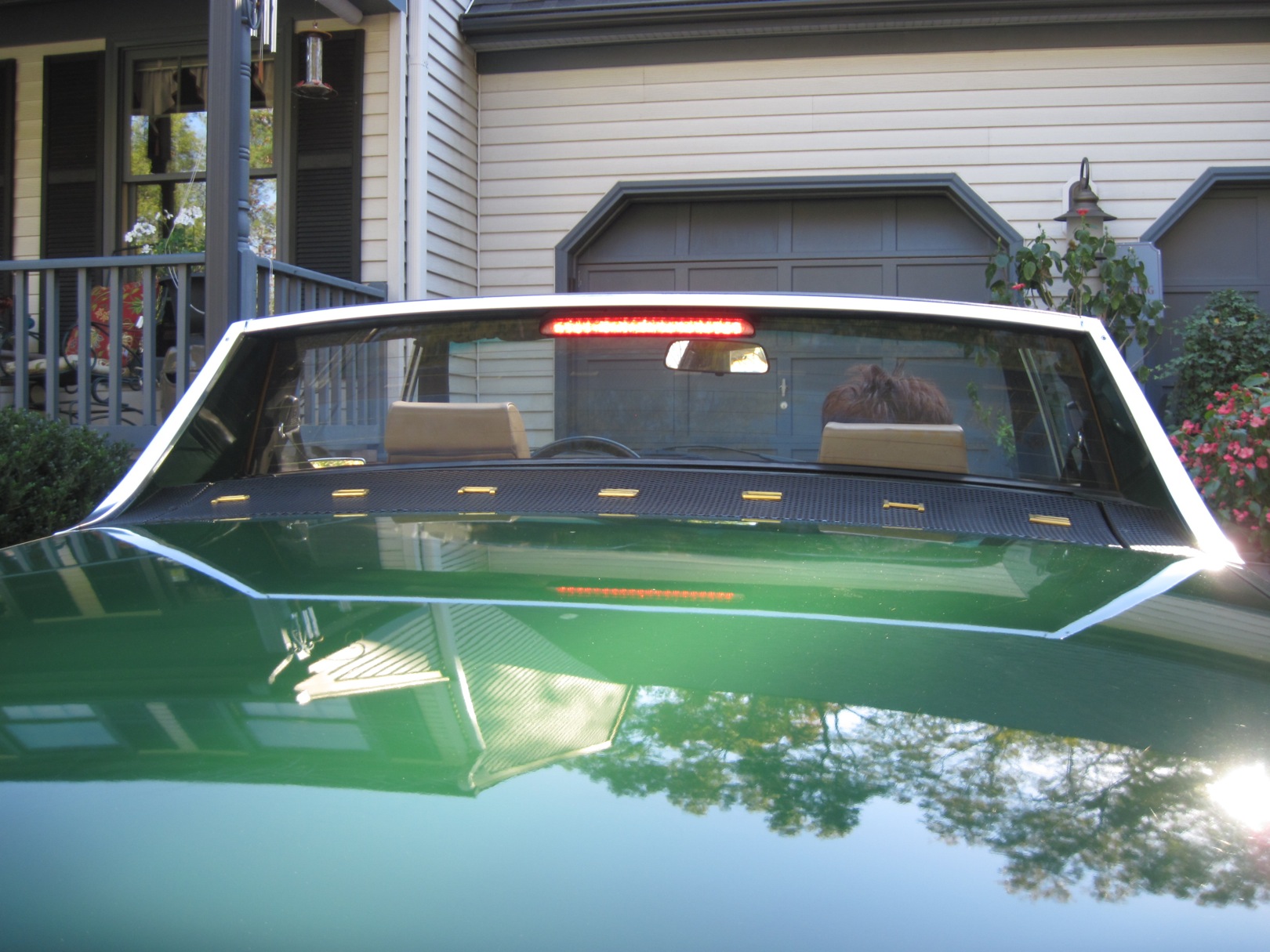

Im going to try some of the little, high strength magnets, superglued to the light.

QUOTE(mepstein @ Apr 27 2017, 07:54 AM) *
That's how I attached mine . . . also a quick disconnect for the wiring. I can remove it all in a couple of minutes if I needed to. Going on 5 years with no problems.
The light is from a Volvo V70 (I think), with the same strobe module as oakdalecurtis.
BTW, I used a piece of thin mouse pad on the magnets so they won't mar the paint (IMG:style_emoticons/default/smile.gif)
