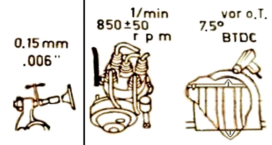

OK; I think I have it. Have added the decimal in front of 006" and cleaned up/mocked up the timing marks. The bottom one still looks odd (no separate notch horizontal line like the top, but that's what the original seems to look like). What do you think, @oakpark , @VG-914 and @JeffBowlsby ?
