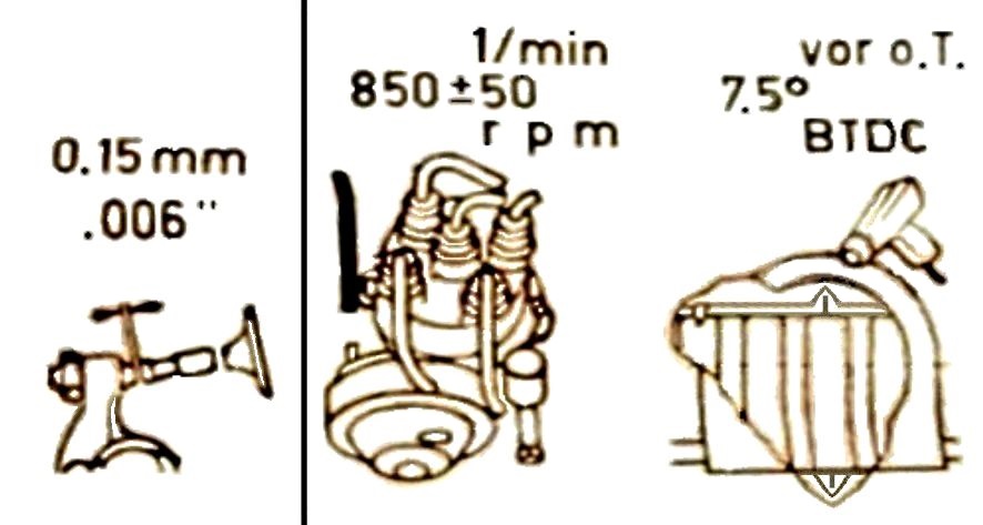

One last set of touch-ups. If interested, also made a parallel one with double lines across the bottom timing mark to match the top, but don't think the original had it.Attached Image
