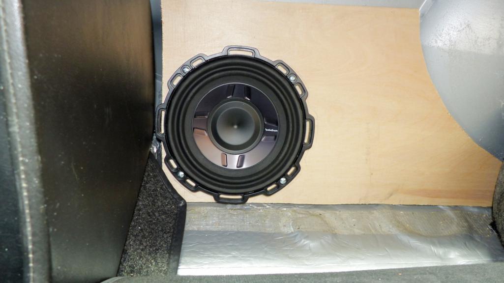

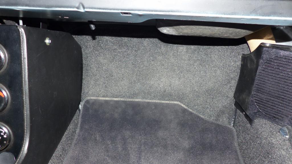

Posted this on my build thread a month ago but figured I'd update here. I think the Rockford-Fosgate sub will work in the foot well location. I just have it mounted on a cheezie temporary board for not until I can get that awesome enclosure Mark is working on (IMG:style_emoticons/default/poke.gif)
(IMG:http://www.914world.com/bbs2/uploads/post-20845-1586067181_thumb.jpg)
With the enclosure, I'll rig a flush mount with a sturdy grill to keep feet from poking through. I might have to sacrifice about 1/2" of foot space to make it completely flush but won't know for sure until I have the box. Even with the cobbled setup, it is pretty stealth.
(IMG:http://www.914world.com/bbs2/uploads/post-20845-1586067451_thumb.jpg)
Sound-wise, I liked the JL Audio sub better but this is pretty nice after it got broken in a little. It's a bit wimpy running free-air on that board though so I'm really looking forward to having an enclosure so I can button this up.
