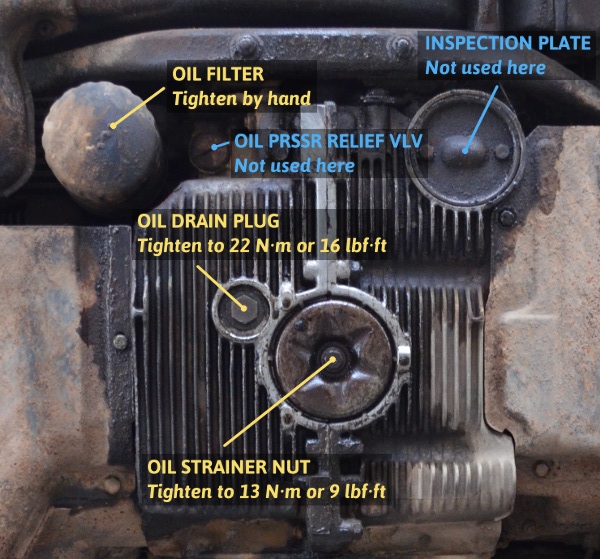

So I need to do an oil change, this is my off season for driving we have extreme heat now here in S. Arizona. Is the filter and strainer completely separate? I assume you change the filter and check the strainer? Any you tube videos on this?

euro911   RE: oil change   May 6 2020, 11:28 PM
brcacti   Great picture, thanks, my question now is if I...   May 7 2020, 05:21 AM
