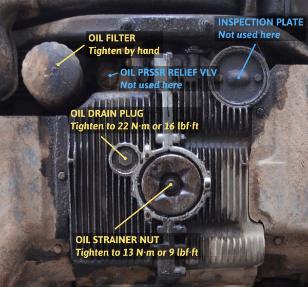

euro911
brcacti
QUOTE(euro911 @ May 6 2020, 10:28 PM) *
Great picture, thanks, my question now is if I change the oil and oil filter would I need to take the strainer off to get all the older oil out?
TheCabinetmaker
It doesn't hold enough oil to worry about. I clean strainer every other oil change or 5000 miles. I clean it to look for F.O.D. (foriegn object debris)
