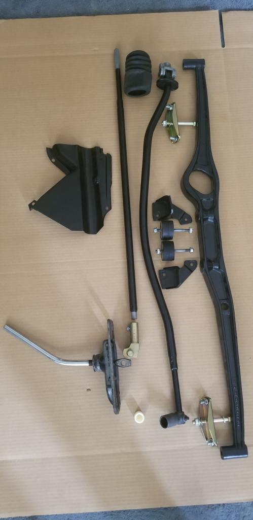

So I have been reading a lot of the posts about converting a tail shift to a side shift, and finally realized that the articles were about actually converting a tail shift to a side shift and getting worried (that should give you an idea of my mechanical prowess). I do have complete linkage from both a tail and side shift transmission. From what I can figure out, besides replacing the bushing all around, the only piece that I would be missing would be a conversion bushing at the firewall? Is that correct? Is there any difference between the actual shifters?
Thanks for any help. |

@n2j2ryan
' date='May 10 2020, 05:57 PM' post='2813792'] So I have been reading a lot of the posts about converting a tail shift to a side shift, and finally realized that the articles were about actually converting a tail shift to a side shift and getting worried (that should give you an idea of my mechanical prowess). I do have complete linkage from both a tail and side shift transmission. From what I can figure out, besides replacing the bushing all around, the only piece that I would be missing would be a conversion bushing at the firewall? Is that correct? Is there any difference between the actual shifters? Thanks for any help. [/quote] Here is a picture of the linkage parts needed to convert to a side shift. The only missing part it the firewall conversion bushing. Attached thumbnail(s) |

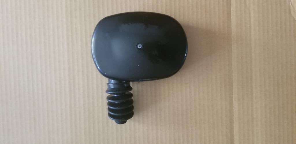

bdstone914 ![]() ![]() ![]() ![]() ![]() Group: Members Posts: 5,424 Joined: 8-November 03 From: Riverside CA Member No.: 1,319 |
Here are the rear shift cover and bellows needed too.
