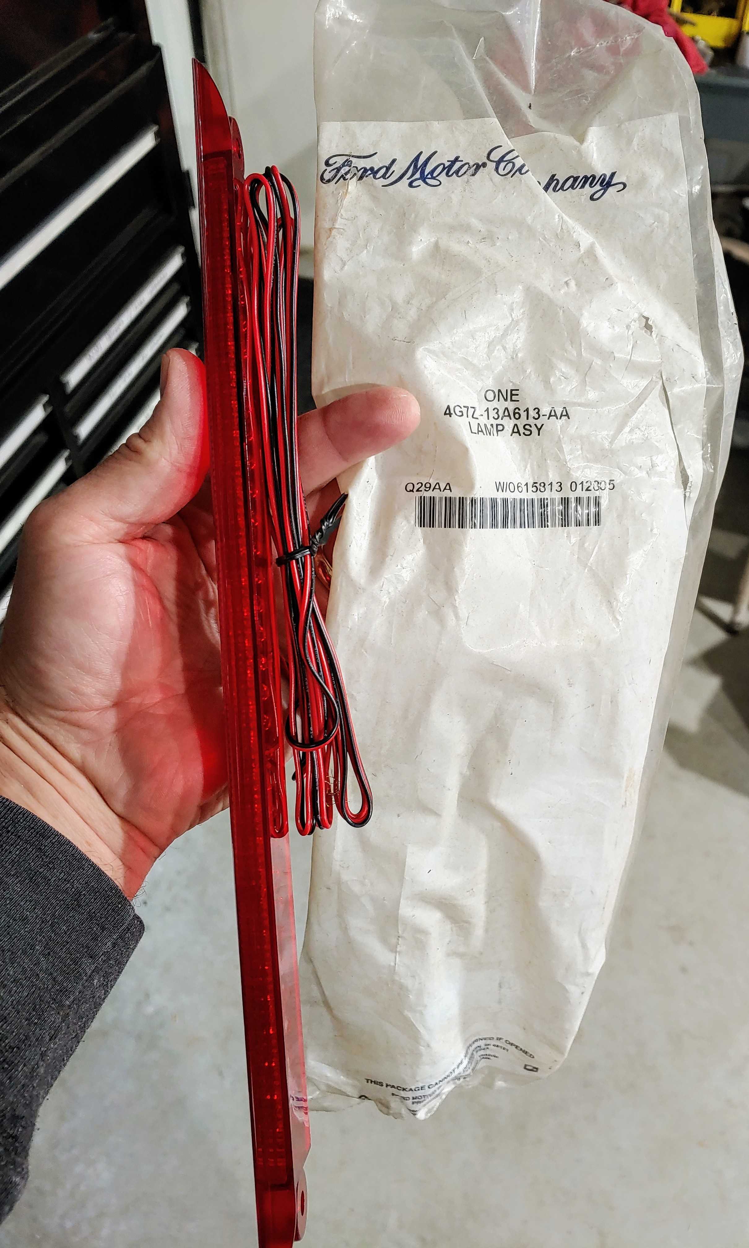

mb911   This is what I have and got it from @georgerud .....   May 19 2020, 10:00 AM
