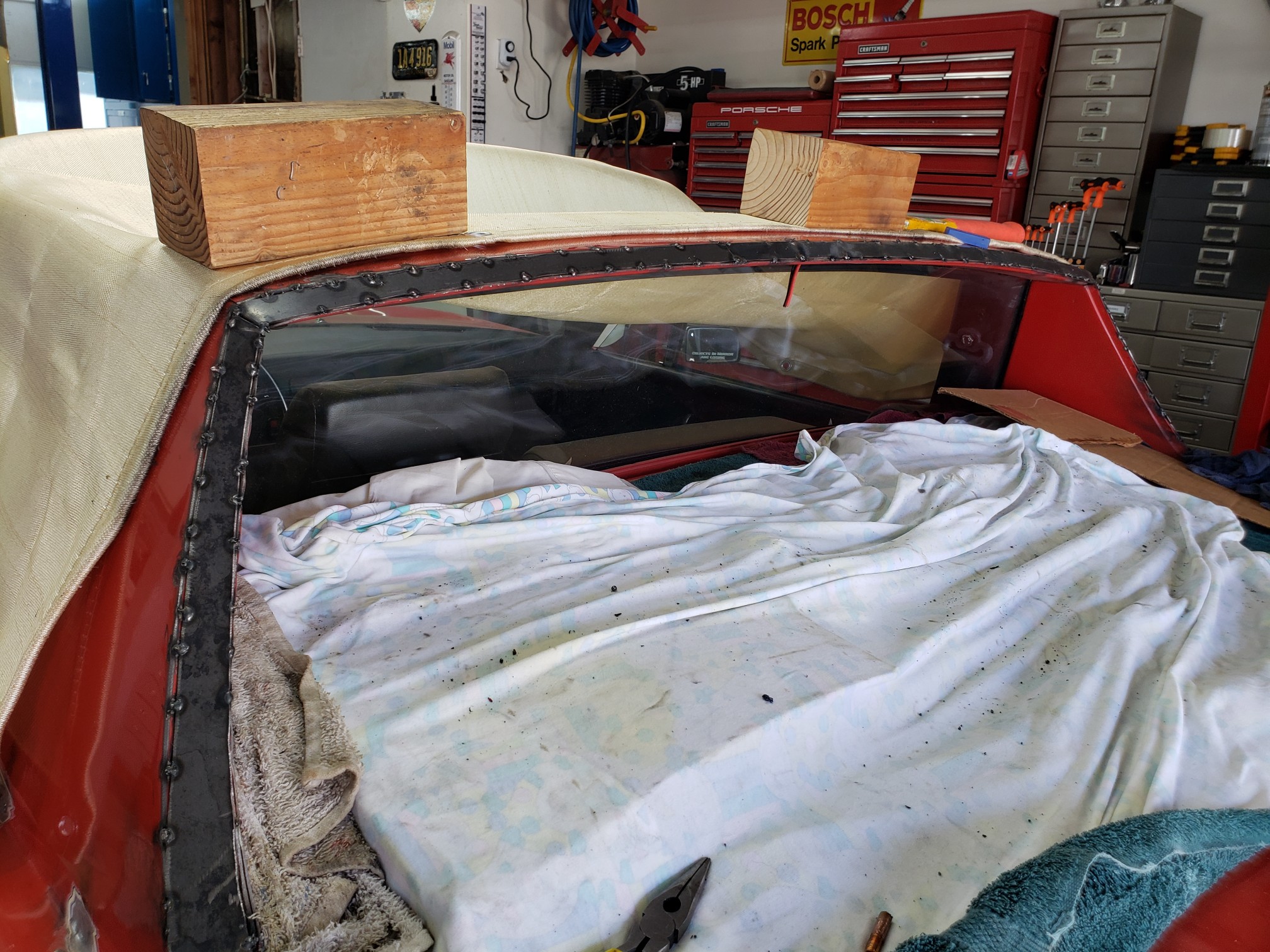

Hey Mike-
On my V8 car I deleted all targa trim so I ran wire underneath sheet metal in place of trim. Careful not to burn wire as I welded metal strips. I ran wire through existing sail trim hole into to trunk, spliced into brake wire. Bingo...done.
Other 914's will get these mounted straight onto rear glass.
I bet they would look sweet cut into moulding (IMG:style_emoticons/default/biggrin.gif)
