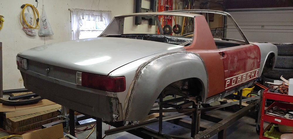

I figured why not start this thread. The car is a 74 914 2.0 that's been sitting since the early 90's. It was parked outside/in the woods up until my brother purchased it last fall. It didn't look too bad from 20 feet away but when you look closer it gets pretty bad. So, here's the plan... strip the car, fix the rust problems, paint it, add a 5 lug suspension, and convert it to a 3.0 6. Stay tuned for pics of the progress..

Rear RD panel is in, R/R flare welded on, Maddog inner frame kit installed, and tested fitted the new rear trunk pan. Need to order some longer spot welding tongs then we can finish up the rear trunk.
