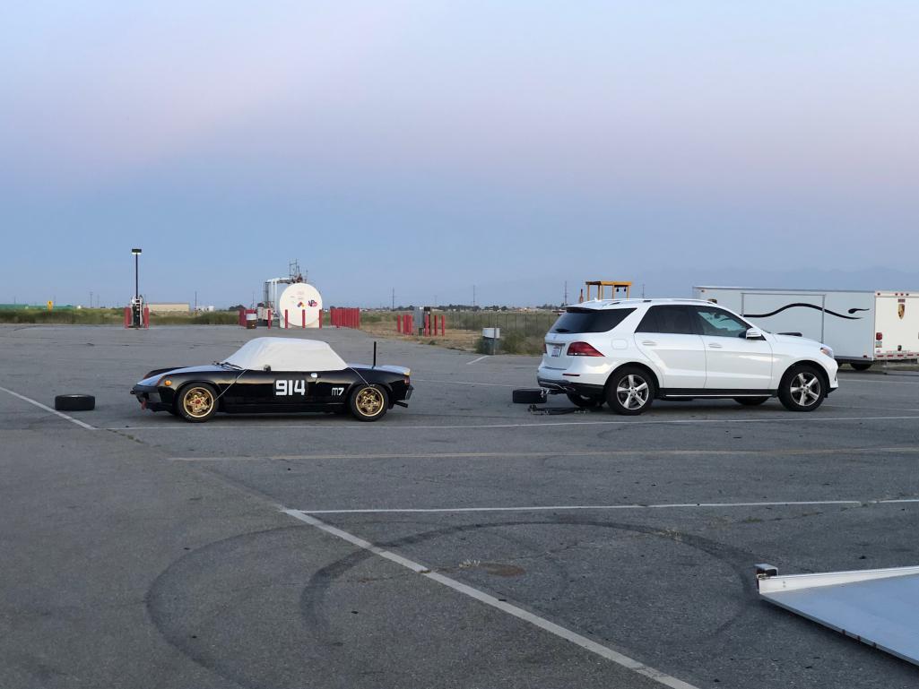

Car ran well in the AM, not so much in the heat, wasn’t too hot but she got harder to start at the end of the day. Sunday morning she fired up Like nothing was ever wrong...
Ready for the AM

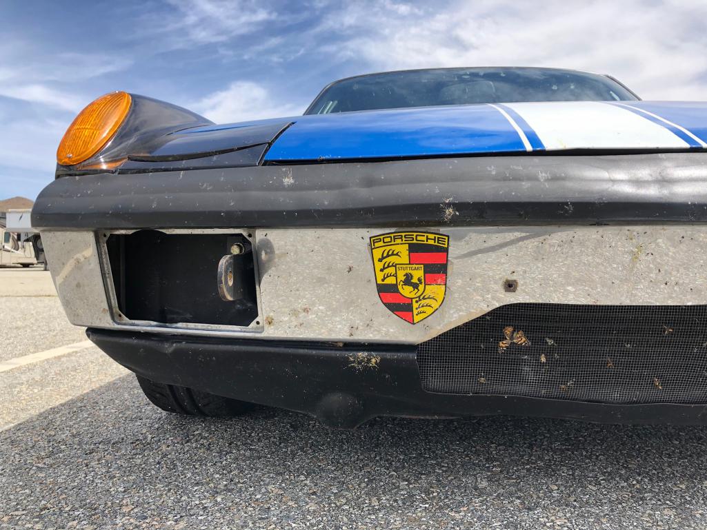

Kills bugs, not quite as fast as a turbo...
