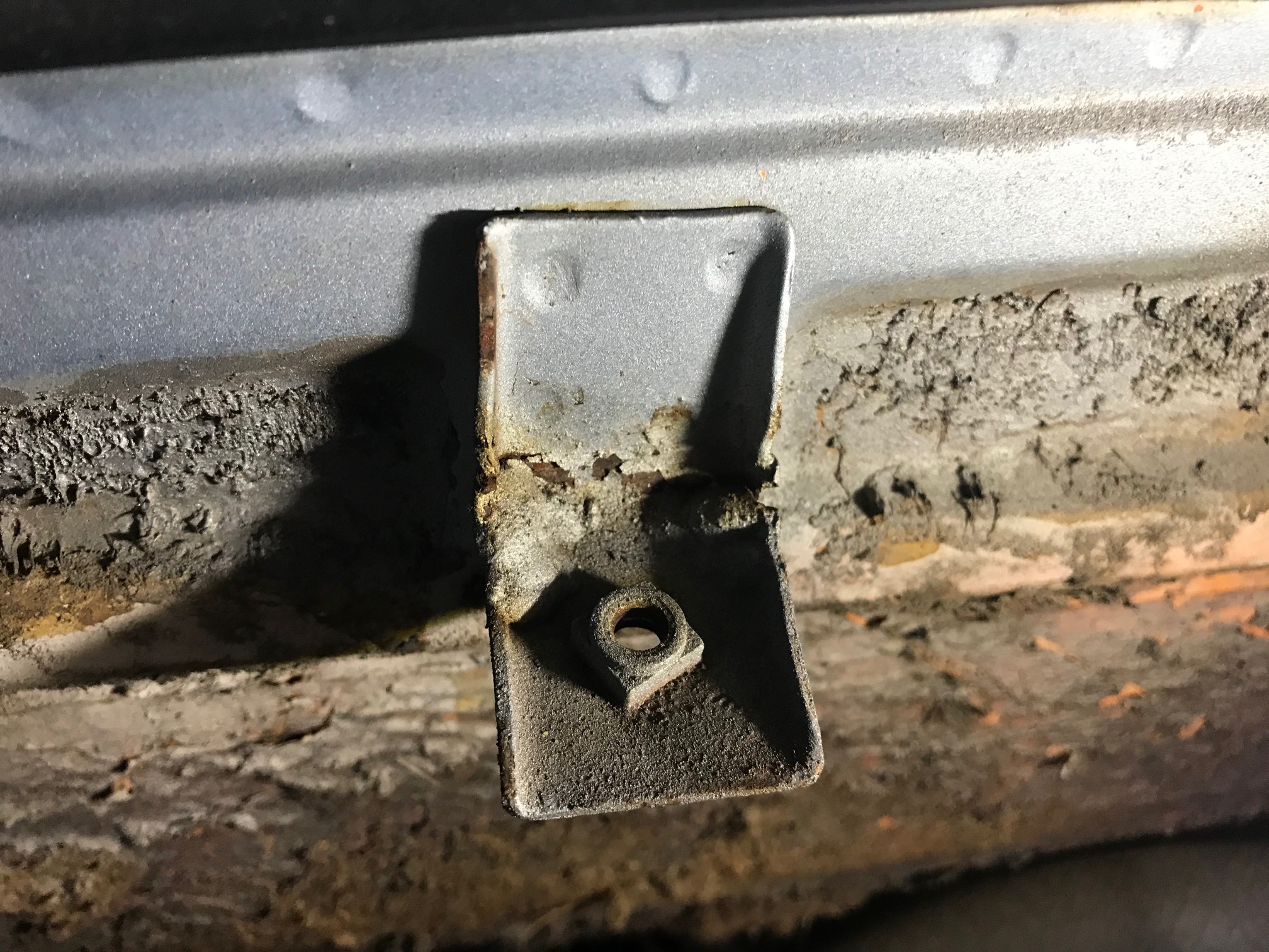

I can think of a couple ways to fix this. Can i hear more ideas?
You can see that there are 4 weld impressions. 3 have pulled a hole in the firewall. Attached Image Attached Image Attached Image

mzalanka   Tape & mask window. Wire brush to metal. Tack ...   Oct 31 2017, 06:08 PM
cary   It will need to be patched. Most of the time the s...   Nov 1 2017, 05:40 AM
malcolm2   It will need to be patched. Most of the time the ...   Nov 1 2017, 07:28 AM
cary   I don't have a car to look at right now. Will ...   Nov 1 2017, 08:17 AM
malcolm2   I don't have a car to look at right now. Will...   Nov 1 2017, 11:44 AM
mzalanka   I wouldn't second guess Cary as he obviously k...   Nov 1 2017, 12:33 PM
cary   How about doing a combo of your two ideas. Lets us...   Nov 1 2017, 09:54 PM
malcolm2   looks like cary's combo idea might be the way ...   Nov 2 2017, 05:57 PM

malcolm2   Well I finally got around to finishing this projec...   Nov 11 2017, 04:58 PM
cary   That dog will hunt ............... Mask it off and...   Nov 11 2017, 08:05 PM
