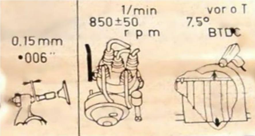

I realize it's a terrible picture, but I'd love help trying to reproduce this decal that is on my 1.8 liter engine.Attached Image

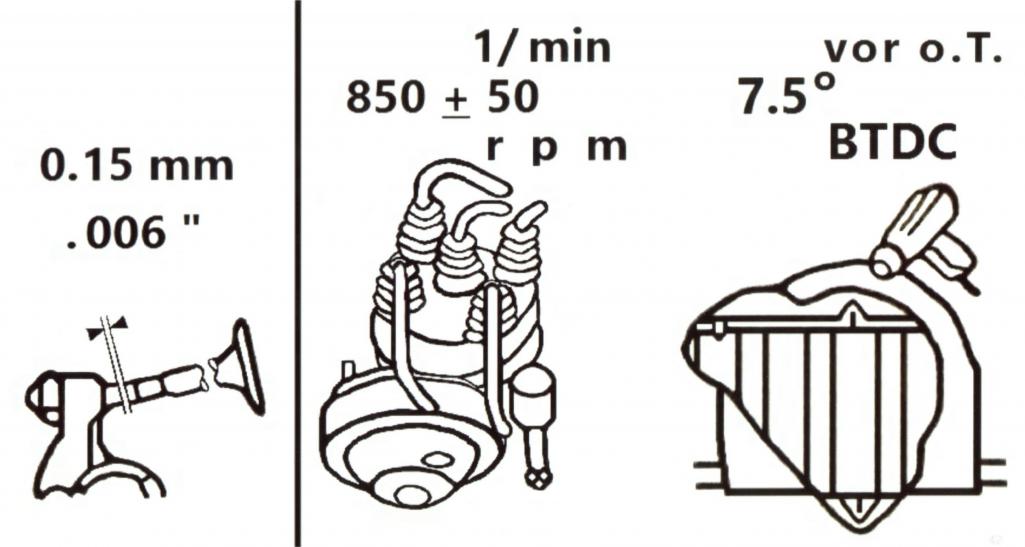

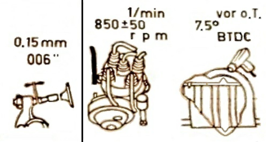

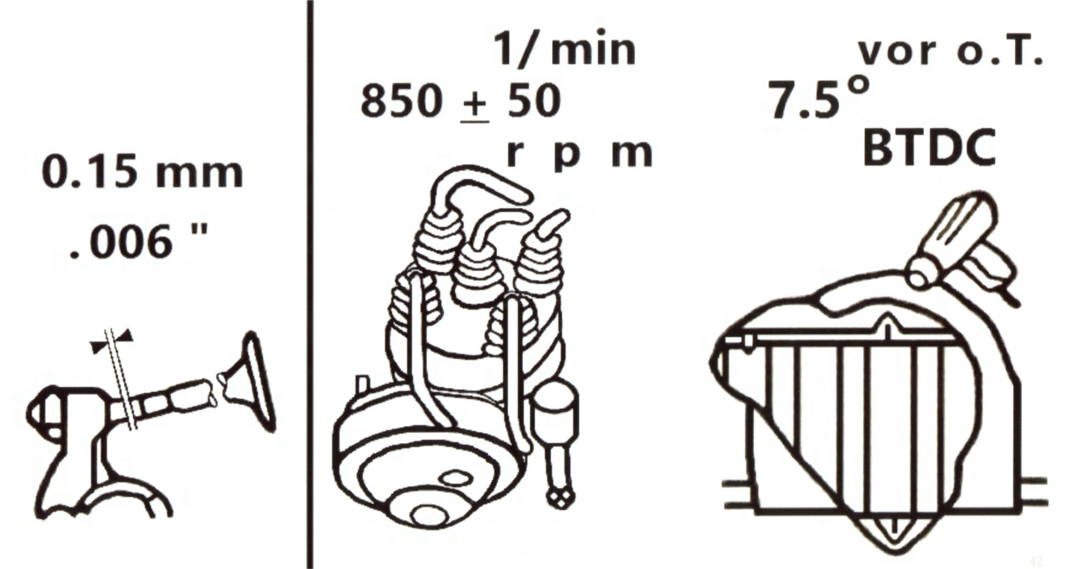

DONE! (IMG:style_emoticons/default/piratenanner.gif) Have created 3 versions, all at proper size (75mm x 40mm) - 1. Original; 2. Cleaned and 3. Restored. If anyone wants to print, just PM me with your email address and which file you'd like; I'll send the full file to you.
Here they are:
1. Original
2. Cleaned
3. Restored (Don't know why this is showing up in a slightly larger size)
Not perfect, but as I noted early on, I'm not a graphic artist and doubt folks could detect glitches in a rather small sticker, in a semi-dark engine compartment. Onward!
