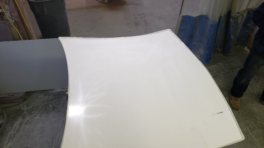

So we have the molds and are cleaning them. We did not get the substructure molds and are making them now. we are looking to pull a set in fiberglass and carbon fiber.
we will have the options to add balsa just like the GT hoods.
Option for headlight delete hoods will be available for both. I will post more as we move along, but we will need to do some repair work on the molds to get to the point we can pull parts. we will then figure out how much they cost to make.
Planning to run 10 sets at a large discount to launch these. Number sill follow
So who's interested at least for now?

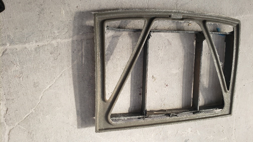

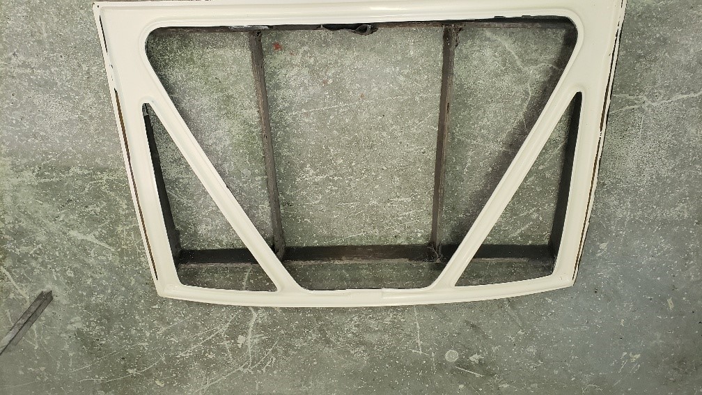

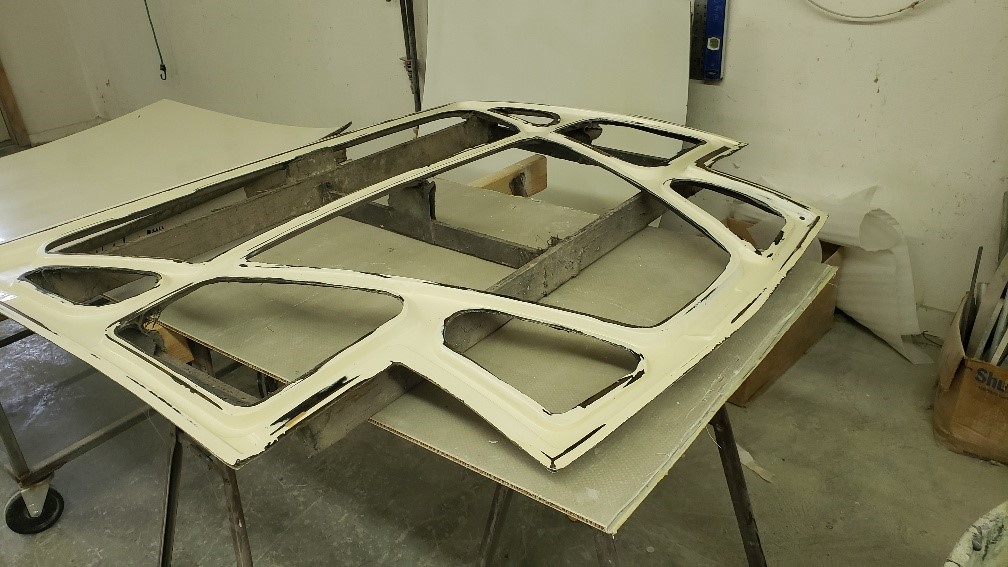

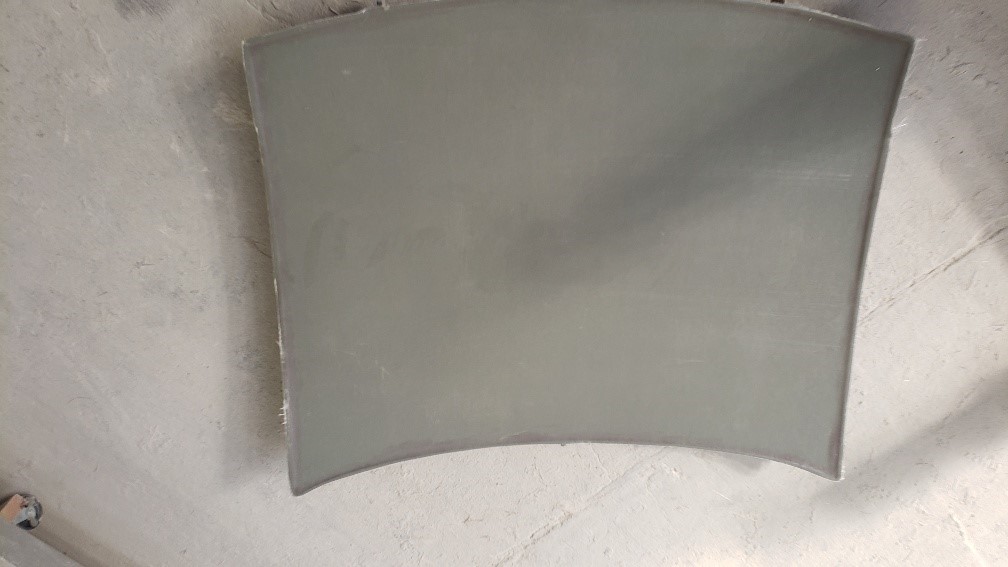

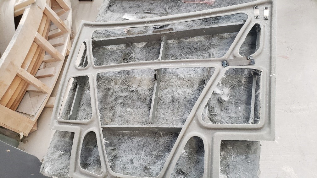

Doing up a front and rear hood assembly, one with the headlight delete 1st
we are figuring out the time and materials needed to ba able to price these. Should have numbers late this week.
